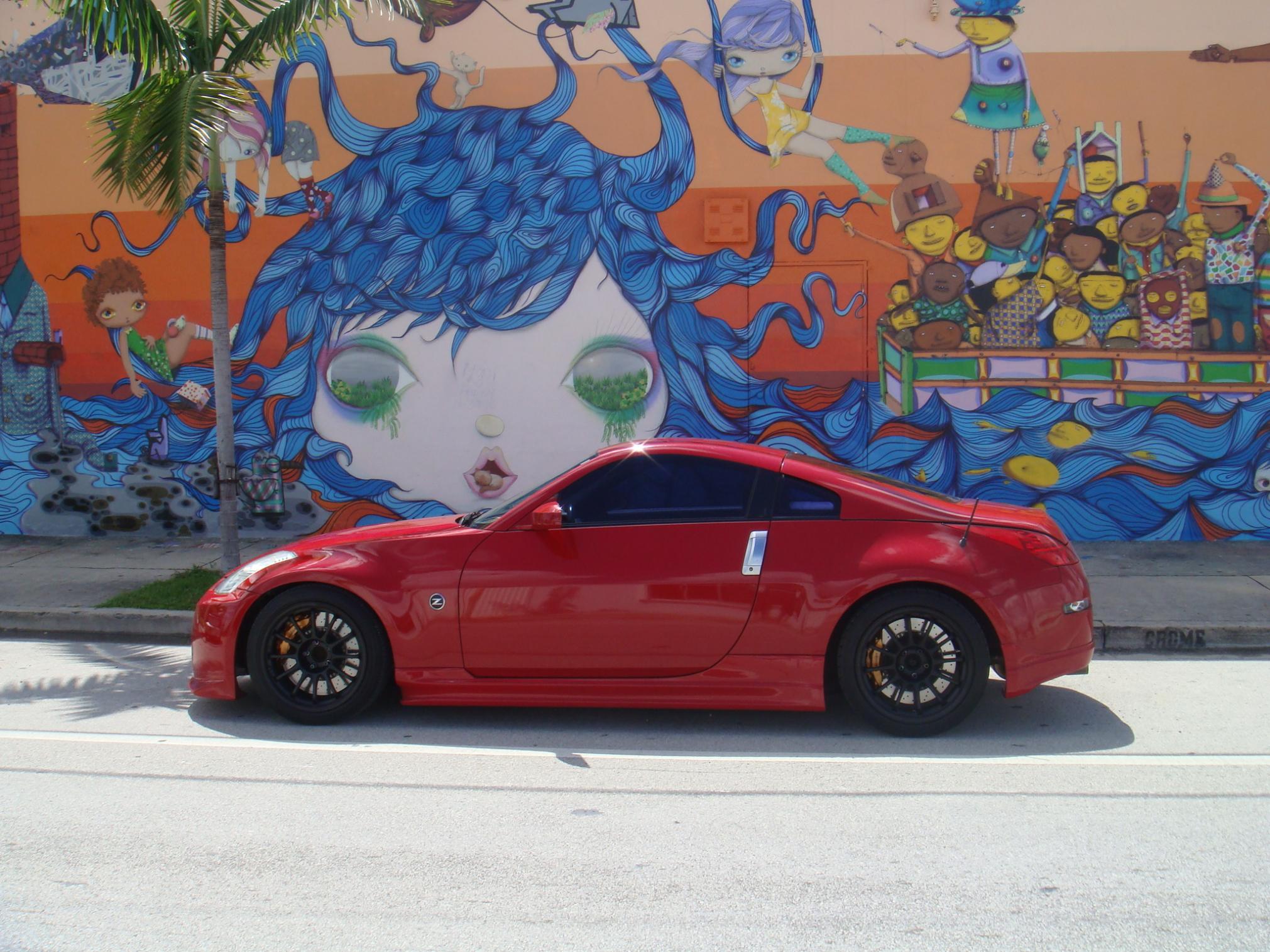

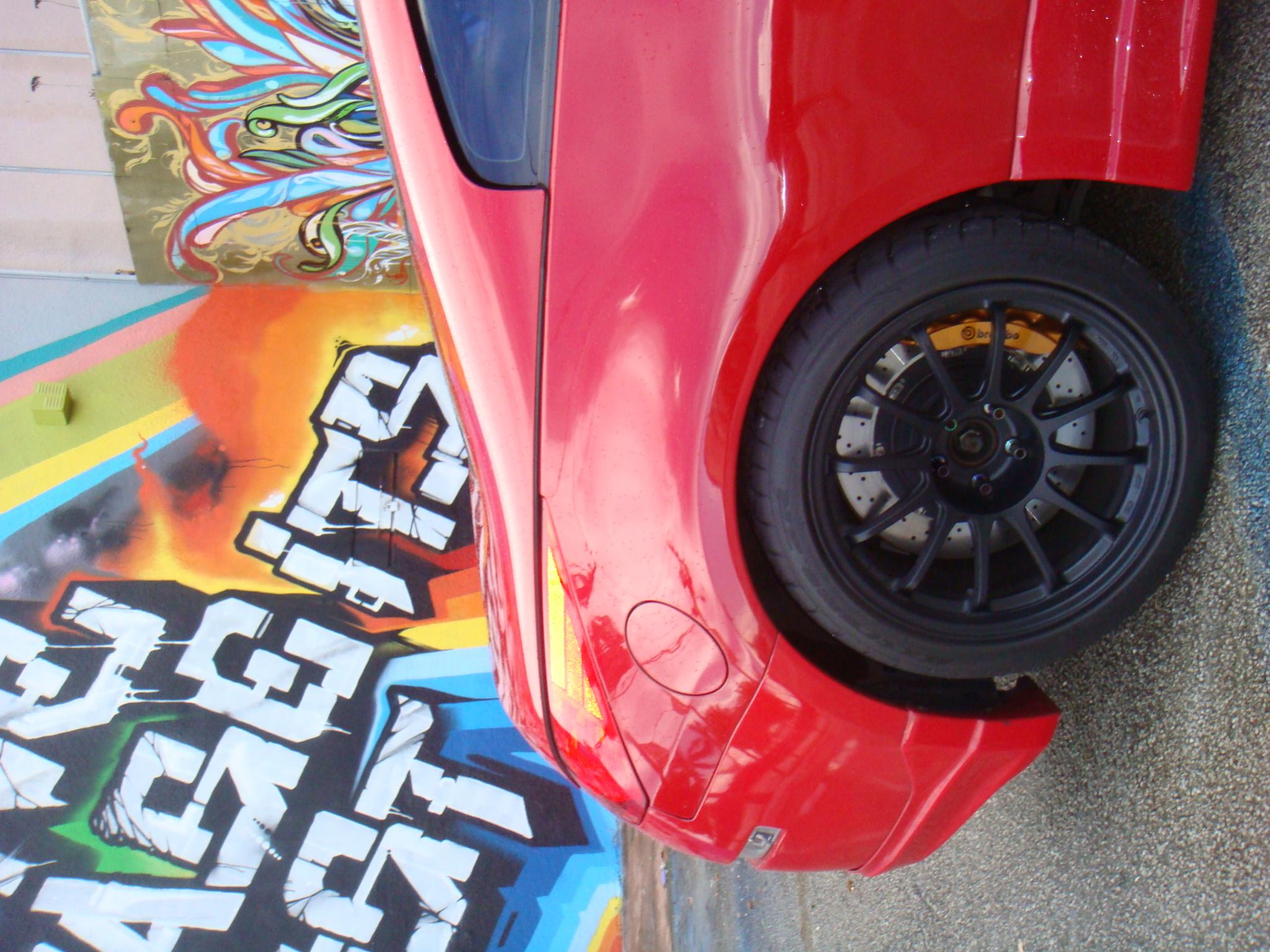

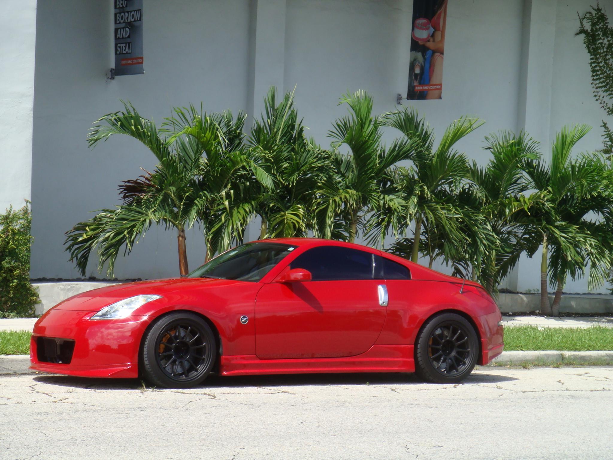

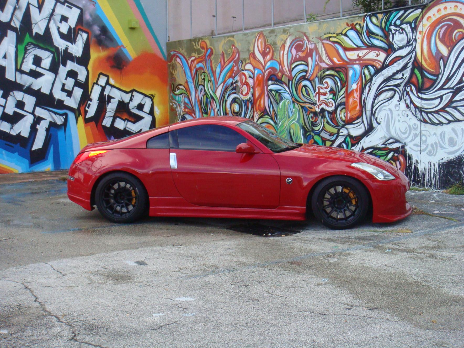

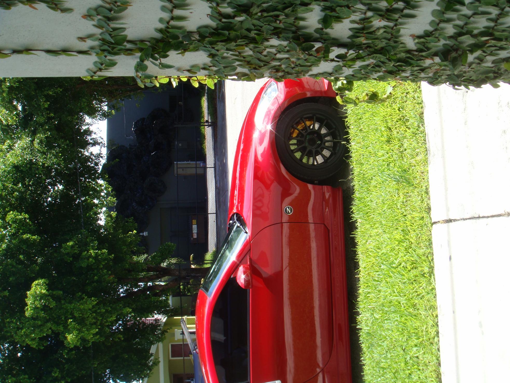

a quick preview of godzilla stopper

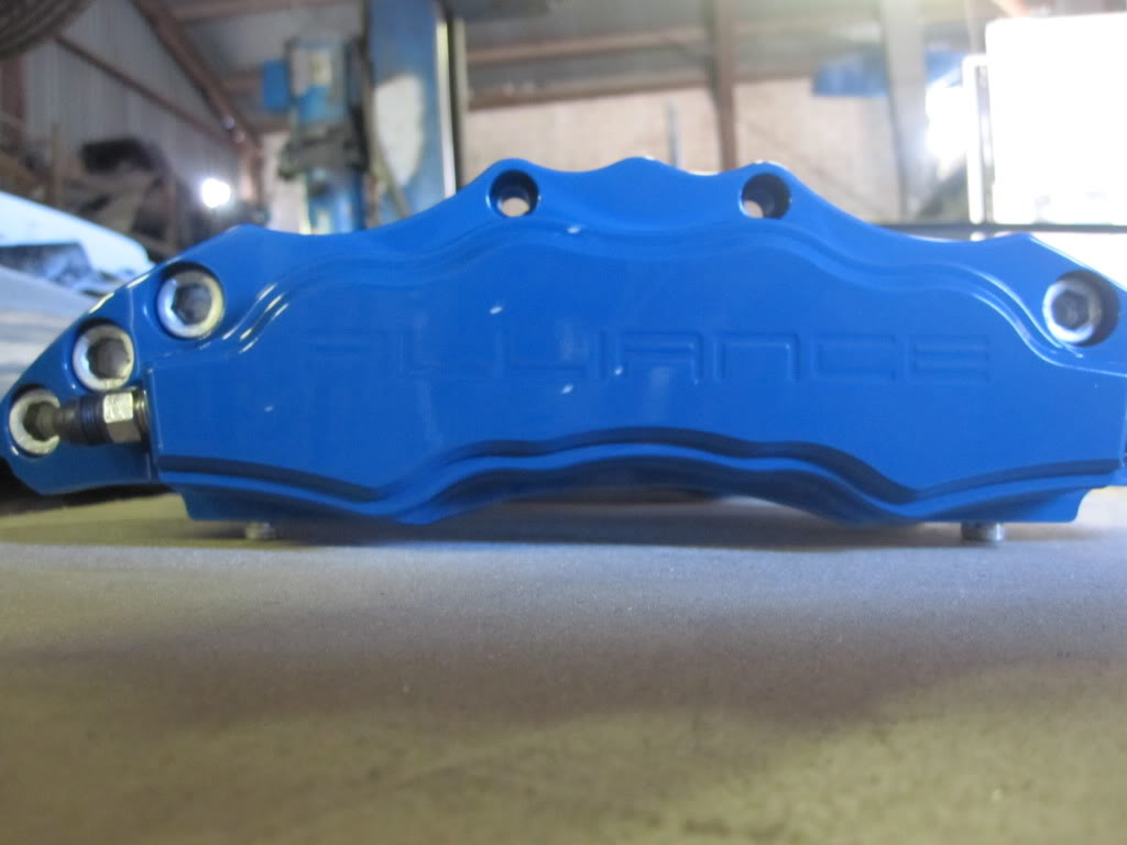

Alliance BBK FTW

Originally Posted by lgear080
I based my opinion on the fact that the setup is not offered as a package out of the box.
That said, surely anyone can make anything work with a little effort
I've finally taken some decent photos of my setup - which will get posted tomorrow.
The setup is fresh nonetheless.
Tell me more about how you fabbed the brackets....
Just had to do alot of measurements, and then check, double check, and triple check. I designed the brackets with the emachineshop.com software. Made three mockups using lifesized printouts with photopaper. Material is T6061 aluminum
Main challenge was giving enough clearance to not hit the top part of the knuckle, while still leaving enough material to make the bracket structurally sound.
Old Aug 30, 2010 | 01:00 PM
  #654
lgear080's Avatar
lgear080
iTrader: (21)
Posts: 6,541
From: MIAMI
That's well done. Ultimately how much did the cnc work cost?
Total on the setup? I am interested in a comp as I did some similar work
(think Green Goblin) on the below... It took a while as he did all of the
design - which I am grateful for as I would have never personally had
the wherewithall to accomplish this.
That said - It should stop well
Mine stops a bit faster than stock (r35).
Attached Thumbnails Big Brake Kit Picture Thread!!!-dsc01792.jpg   Big Brake Kit Picture Thread!!!-dsc01815.jpg   Big Brake Kit Picture Thread!!!-dsc01820.jpg   Big Brake Kit Picture Thread!!!-dsc01789.jpg
