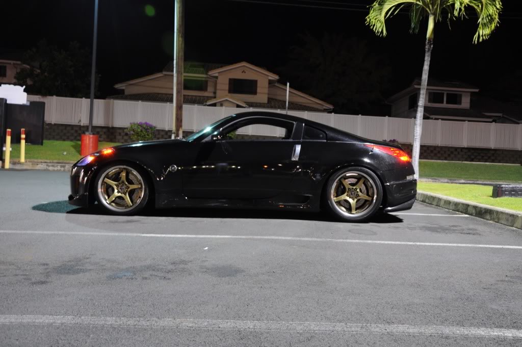

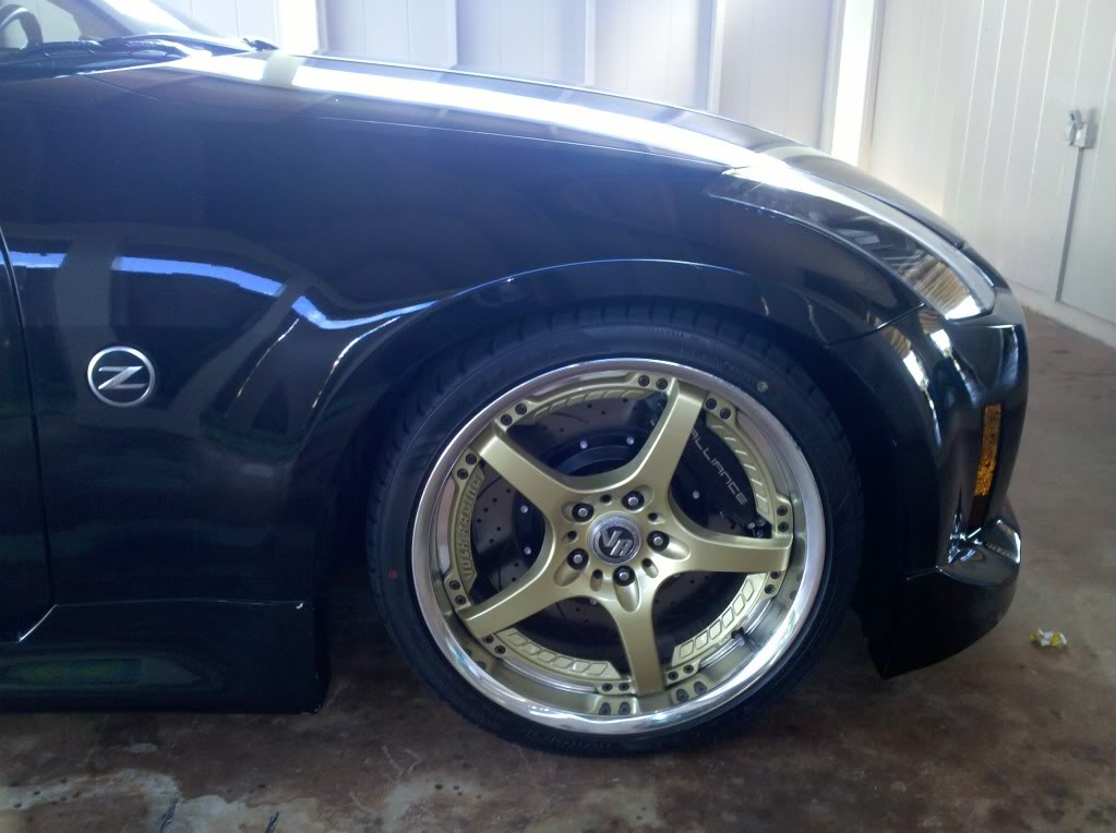

Originally Posted by angelo350z
Looks great! More pics? Specs?
Thanx. There Alliance 15front 14rear that I painted black. they were originally faded yellow

Originally Posted by Atech
2 Sradenton, so how they work, how u feel 'bout 'em?
I really like them. night and day over the old stock brake I used to have.

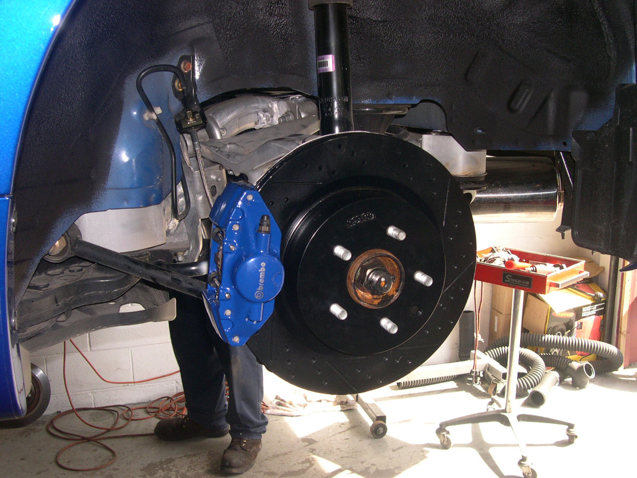

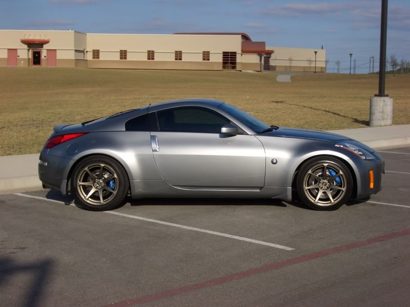

Updated with brakes installed. Only a year or so late.
Rears are factory Brembos powdercoated to match fronts.

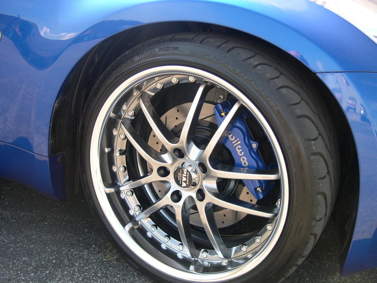

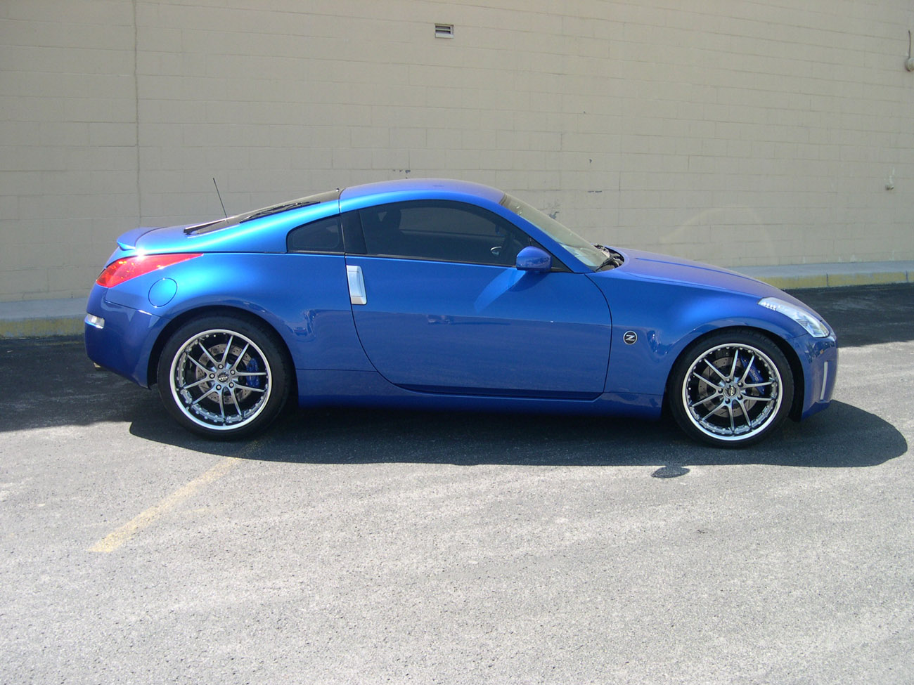

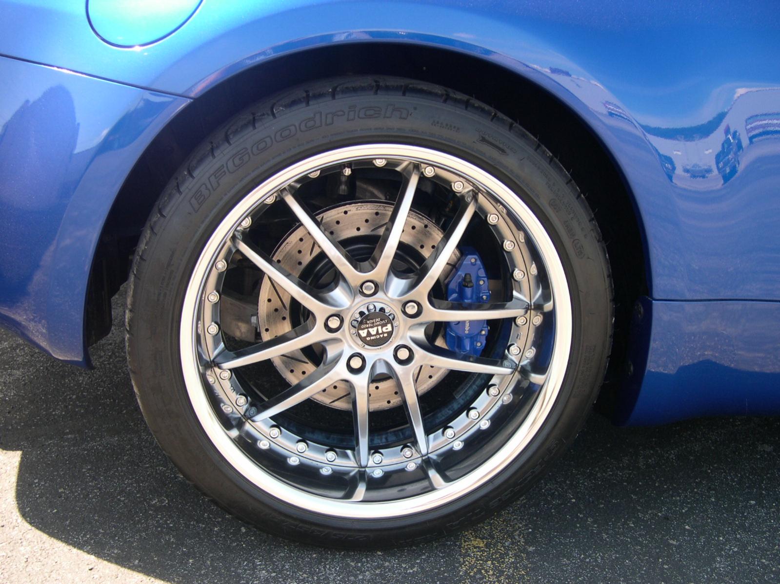

Wilwood 6 piston 14' rotor front, 4 piston 13' rotor rear

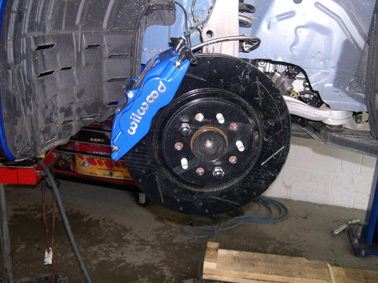

They may not be anything special but they are 4/2 piston & 14"/13" and are in my car for under 1500!

I'm not sure about this, but isn't the rotor facing the wrong way?

the direction the slots face are inconsequential - the only thing that matters is making sure the center veins face the correct direction. On some kits, this will have the slots facing one way, and a different way on another kit

Direction is determined by the internal vanes.
