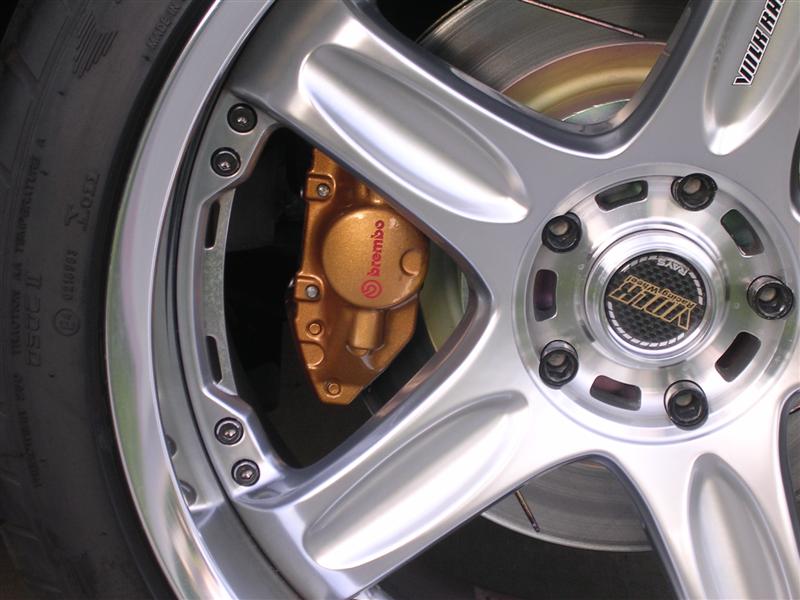

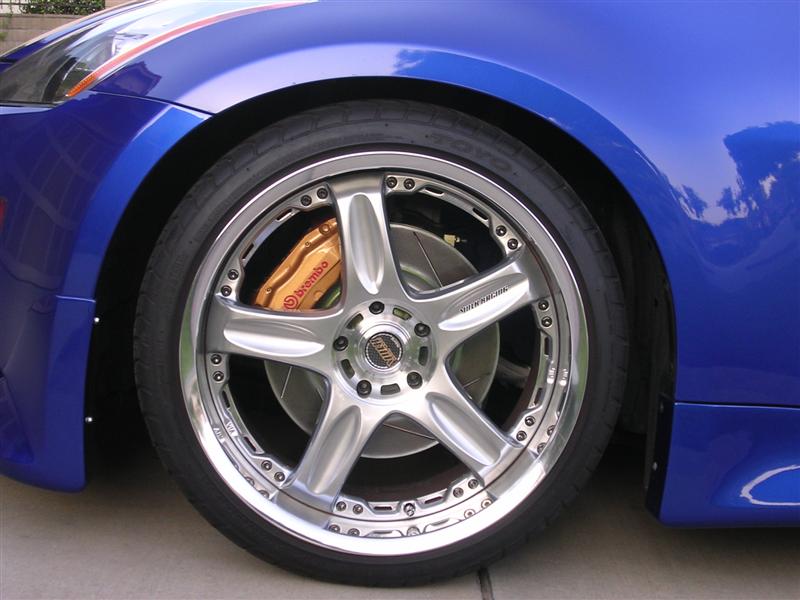

Had mine installed by West Covina Nissan ($300-calipers, new rotors & SS lines). Great clean quality job.
