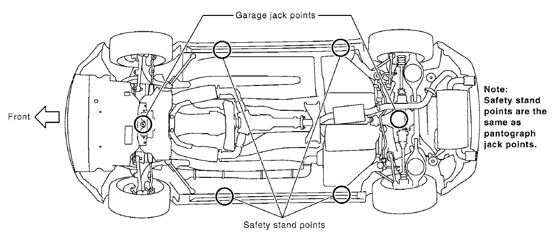

I searched, but couldn't find a definite answer. Tomorrow, I'll be installing my hotchkis springs and exhaust. I was wondering, where do you put the jackstands if I were to lift both the front and the rear? I know not to put it on the pinch weld, but how sturdy is in front of the pinch weld? Is there a better place?

Link

Originally Posted by istan
As for the diagram, I have this pic. I was wondering if they going in front or behind of the pinch weld? It seems that the front goes behind the pinch weld and the rear goes in front of the pinch weld?
