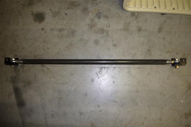

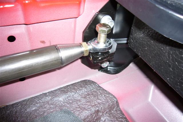

Here are some pictures of my project bars. I need to have them welded up for final installation.
The material is 1" chromoly tubing with 7/16" rod ends. The 7/16" bolts retaining the rod ends to the factory Nismo brackets are a net fit in the brackets's holes.
Note that the front bar will actually mount above the bracket in the final installation, I only mounted the rod end below so I could measure easily.
Note in the picture on the far right I have drawn in the extension of the frame rail under the radiator shroud that the mount bolts to. This frame rail is only supported by the bumper attachments and this is why there is flex at this point. The new bar functions the same as a strut brace across the shock towers but forward and lower.
Photos from right to left are 1) Front bar 2) Rear Bar 3) Rear bar end 4) Frame rail showing how the bar ties together what is a big "U" shaped element of the chassis 5) Bottom photo is of the end of the front bar showing how the bar will mount on top of the bracket finally

Very nice piece cupcar. Give you a lot of credit to craft something of your own. How do you like it so far?
~Robert

Well, my bars are welded, painted and installed.
I have only driven the car a bit, but it seems that steering response is a touch better.
It does also seem there may be more tire noise than before though- maybe this is what Nissan is tuning out with the shocks they use.
I will need to drive more and get to a place where I can work the chassis to see if things are really better though.
