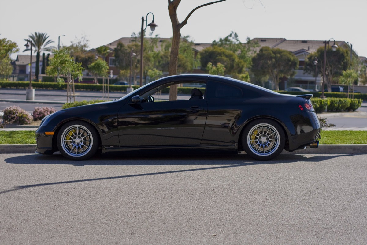

I recently purchased a set of 18" Enkei NT03+M wheels and they clear my StopTech 4/4 355mm setup with no problems.
