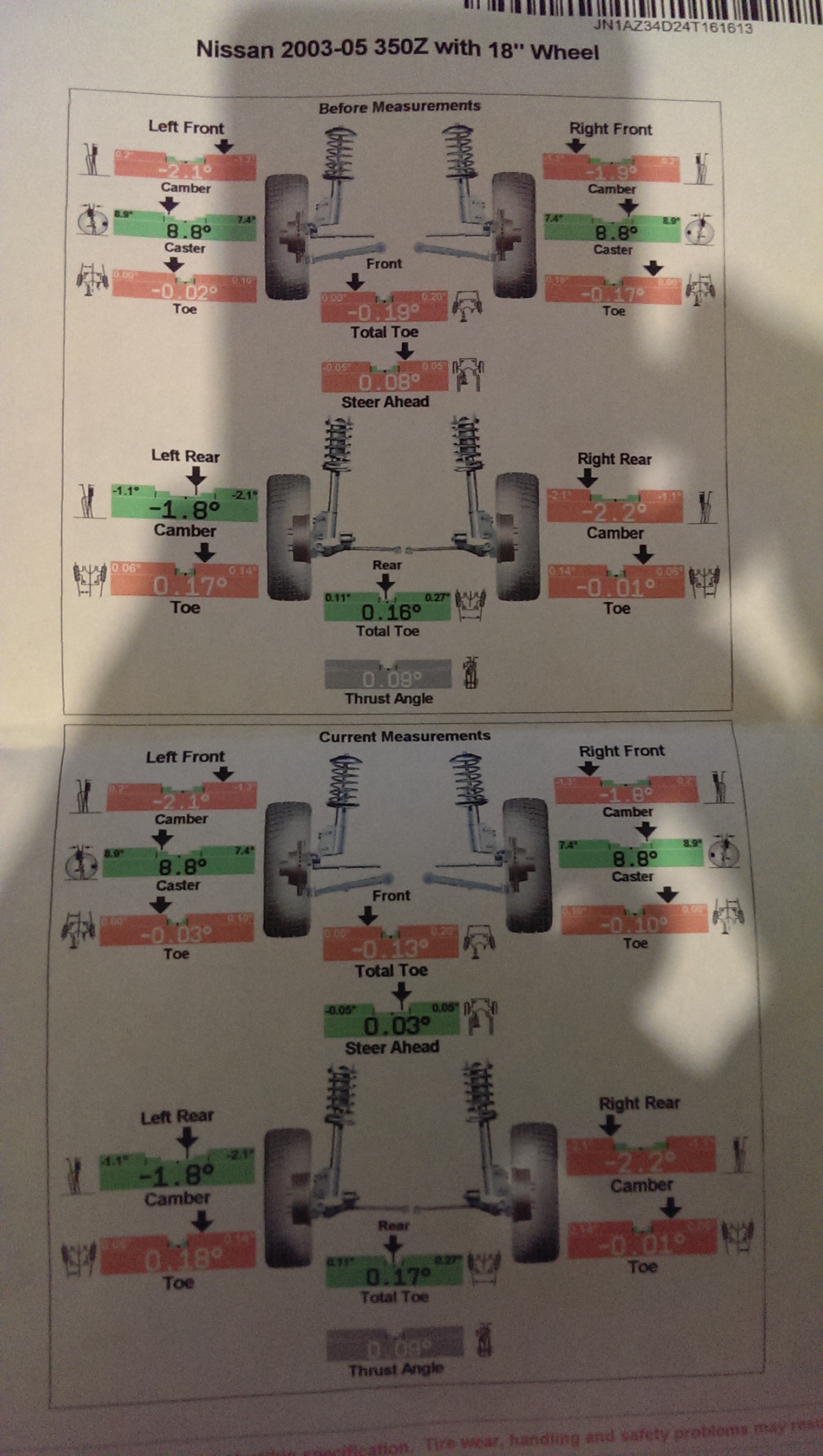

heyyy if anyone still reads this thread im having horrible camber as well. Ive put a cmber kit on but it didn't seem to do anything and im having to get new tires every few months. if anyone can help me remedy that it would be awesome like maybe a link to a certain kit or something to get rid of it. its getting expensive

post a pic of your current alignment sheet.

I hate to sound stupid but is that something I get from an alignment shop showing the measurements?

Yes it is, you just have to ask for it.

sorry for the late reply. yes my cars aligned. it has been several times

Looking at alignment specs I would bet you have about a 1.25 inch front drop and slightly more in the rear.
Front camber arms are needed if you want to change front camber. I would leave it for better handling but that is why I own my Z. The rear needs a simple set of camber arms and toe bolts to get it back to spec. It is your rear toe that is killing tires.

so the rear is making my front tires show steel after 5 months?
ive had the car about a year now and ive put two new sets on and one now that had about 80% tread.
my back tires really have no wear on them. Its still the same set that's been on there since I put on my new wheels.
If you have any suggestions for cmber arms for the front that would be great.
