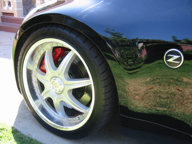

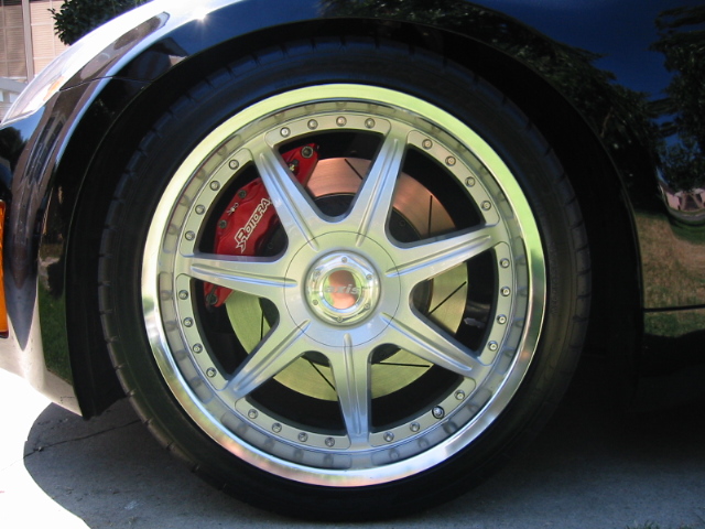

Default 6 pists w/8 slots,,,AAAWWWW!!!
Just the front forr now..to late to work last night..will proceed later for the rear..will send more photos when its done

OOOPs,sorry guys..different rotors..they are covered...

what is the rotor size??? 300 mm or 355 mm????
does it comes with a 4 or a 6 piston caliper???

They are,355mmx32mm..6 pistons front & 4 pistons rear...
