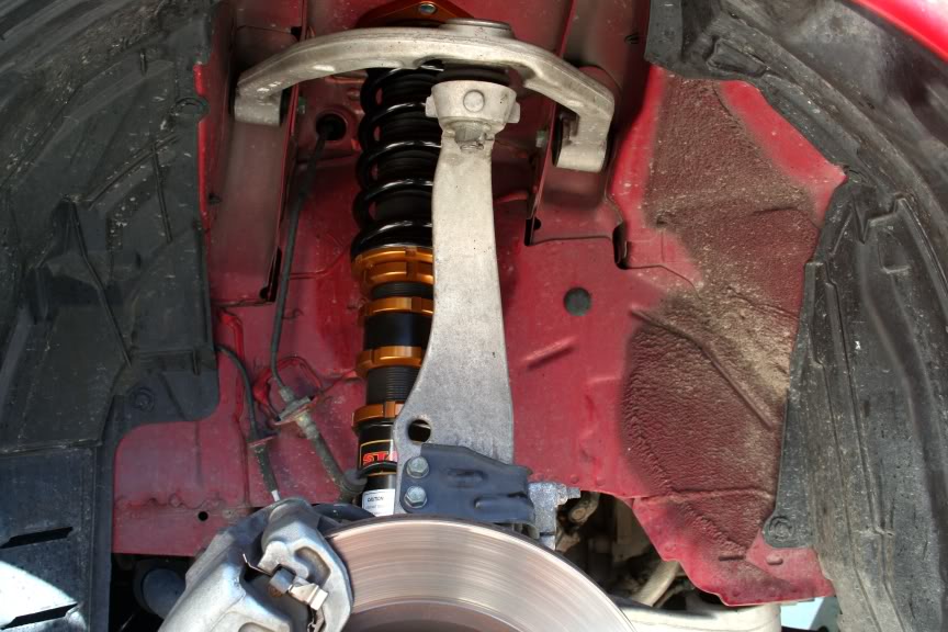

these pics could help for diy installations....
plus i jus wanted to show off my new setup... thnx to Z1 Performance and IntenseAero

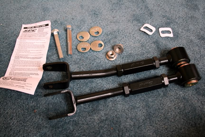

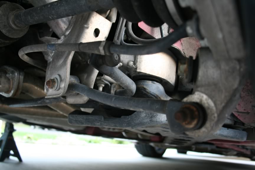

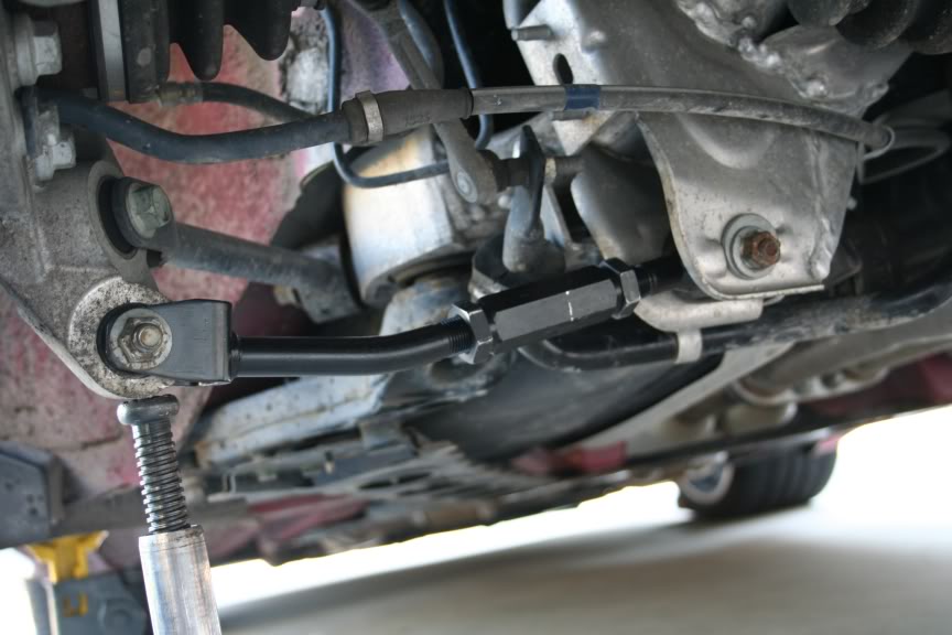

SPC Rear Camber Kit

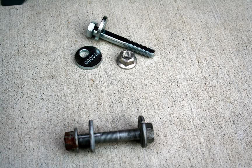

~new and old toe bolts

~many ppl think u have install the new toe bolts on the camber arm, but thats a negative!!

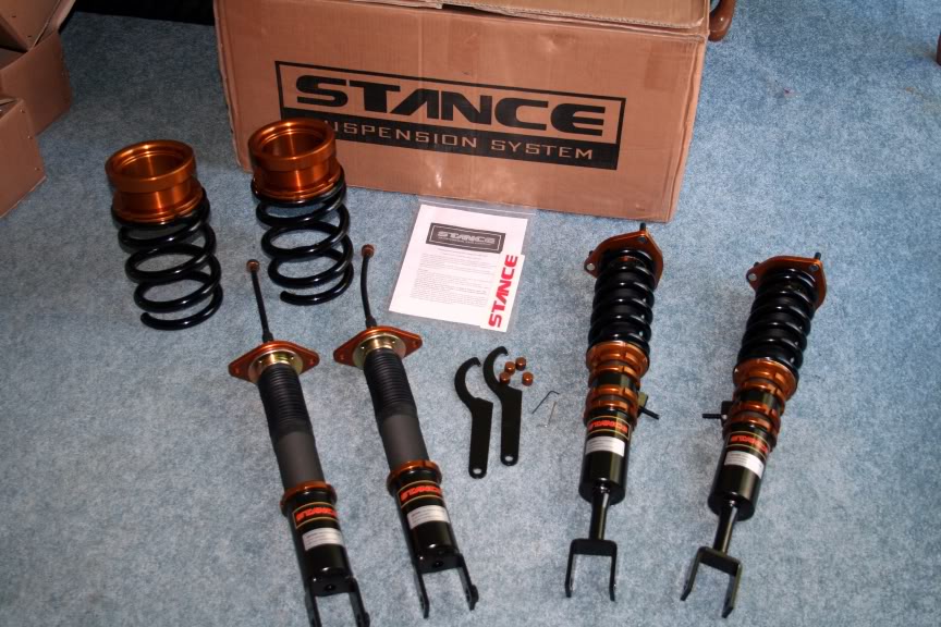

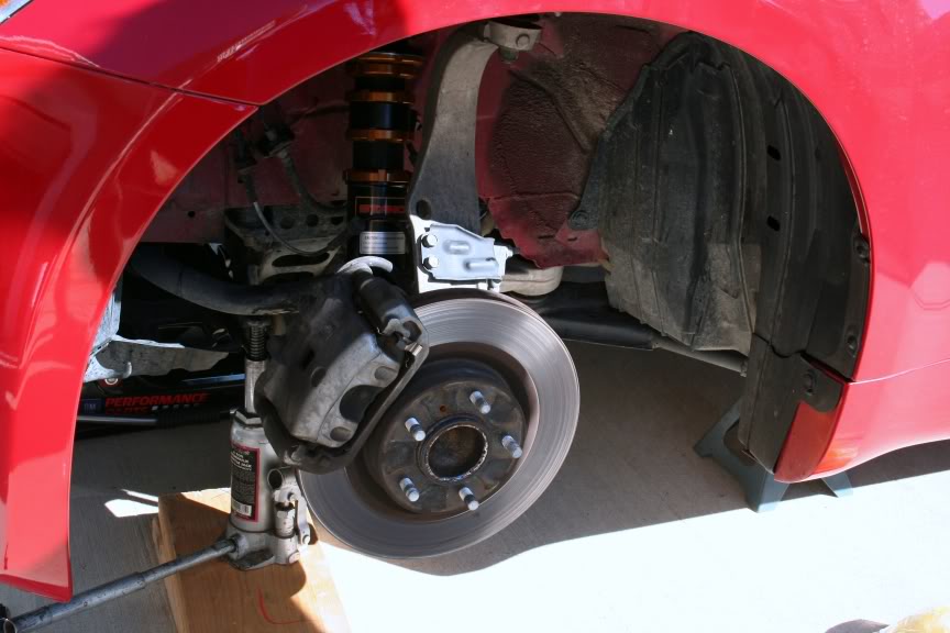

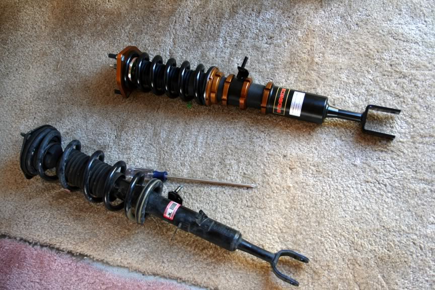

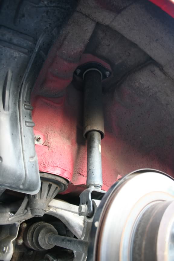

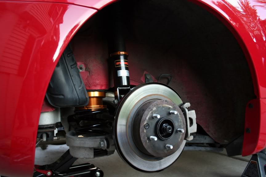

Stance Gr+ coilovers - oem progressive style rear- 12k/11k

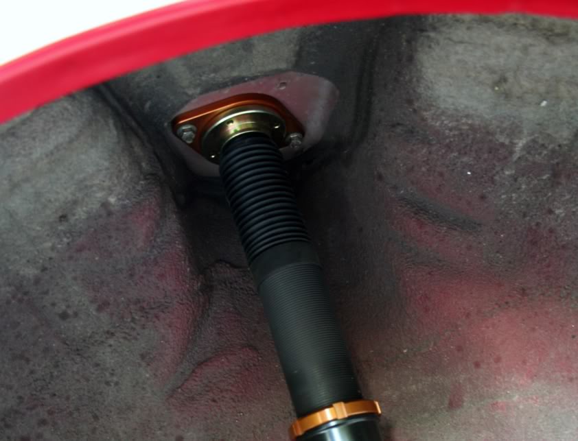

~notice the rear damper **** extensions

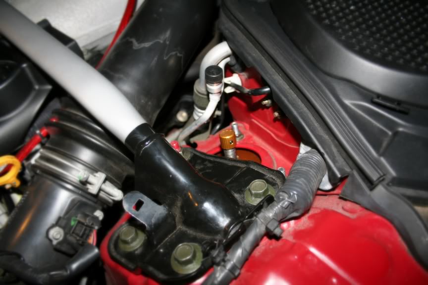

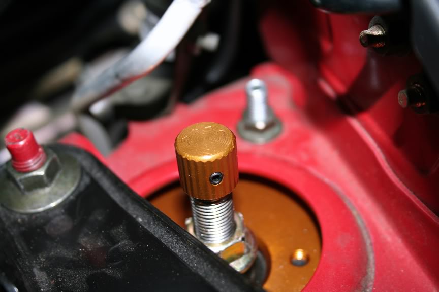

~front damper adjust ****

~rear damper adjust **** w/extension

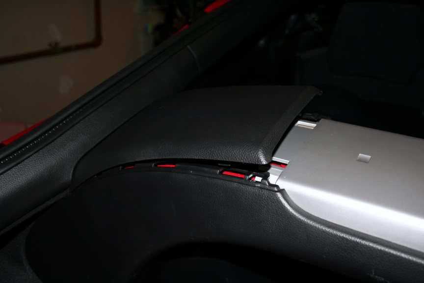

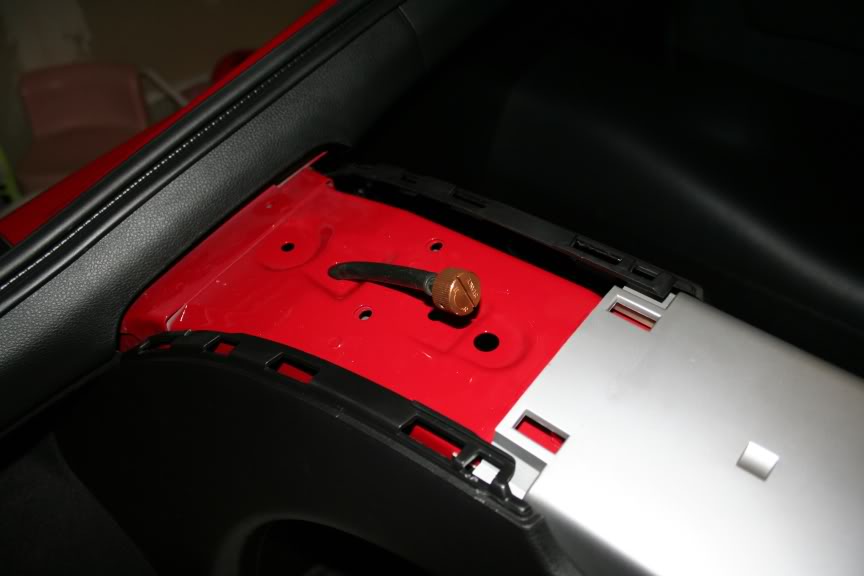

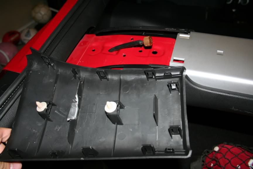

~needed to mess with the cover to fit the ****

Nice pics...those stance coilovers look like quality parts.

Nice pics...so where exactly did you put your toe bolts?
Also..I'm about ready to go back and put on my rear rubber pieces as I have the GR+ Pro's and they rattle w/out the rubber pieces on the spring.
I'm running full stiff in front and on 8 in the rears. Any pics of how low you went? I'm pretty much as low as "w/out rubbing" possible in the front and slammed in the rear but had to cut my rear lips.
One other tip...re-check/re-tighten your camber arm adjusters every now and then. I had my driver side loosen up on me awhile back and I drove about 200 miles before I really noticed it.
Once again...great pics but I wanna see some pics on how low you went also.

~i put the toe bolts on the inboard side of the spring bucket...check the pics it is circled...
