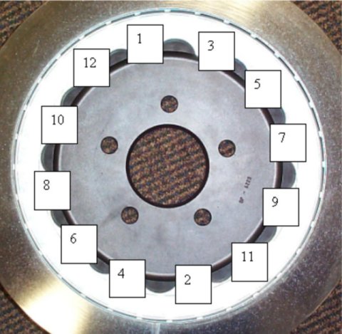

Just for clarifications sake, the 2 links that Mike W. posted are NOT of the brake kit from Precision. They are pics of my kit. www.350zbrakes.com and www.G35brakes.com
I'm sure there will be many questions of why the Precision kit is $1,100 vs the $2,000 for my kit. First, Precision is using Wilwood rotors and hats (nothing 'wrong' with them). I use a custom full race rotors and custom rotor hats with a different mounting mechanism that I believe is better (my opinion) - of course my per part costs are also higher than Wilwood since I don't produce in their quantities. Second and most importantly - my kits come assembled (rotors and hats). I was very surprised to see that the Precision kit was not as it is EXTREMELY important that the rotors and hats are all torqued equally and in the appropriate pattern to keep them from warping. Obviously it takes a good amount of time to do this right.
Lastly, my kit with 13.6" rotors will fit under the stock 350z and G35 17" rims. The Precision 14" kit will not.
So you are saying that because the kit isn't torqued and assembled, that they have a higher likelyhood of warping and cracking?? By warping, I assume you mean bending.
Old Sep 7, 2003 | 10:28 AM
jak's Avatar
jak
Posts: 483
From: MN
The instructions I got with my kit were to tighten the bolts to the rotor hats in a sequence similar to tuning a drum head. The instructions for this were to maintain propper true not cracking.
They say to torque each bolt to 15 ft. lb. and also use locktite. It looks very straight forward and easy to do.
Jeff

little_rod, Jak beat me to the response and he is correct on what I meant - warping of the rotors.
Keep in mind that since you the customer are doing the assembly, you also have the liability. So if your brakes do end up being out of true (and on a big brake kit, 4 thousandths out of true can cause pretty big vibrations), you don't have much of a case to say that the warpage was due to defective parts....so you will have to deal with cutting the rotors.
BTW, and I know this from experience, if you inadvertantly torque one of the bolts to "18ft/lbs" instead of the instructed "15ft/lbs", that is all it takes to cause the warpage.
I'm not slamming the kit, just educating about the potential 'bumps in the road' with this non assembled kit.
Old Sep 8, 2003 | 05:31 AM
jak's Avatar
jak
Posts: 483
From: MN
Russell,
Thanks for the heads up. The rotors seem awfully rigid and so I didn't consider the hat assembly would be that critical. I will be extra careful torqing the bolts.
Jeff
