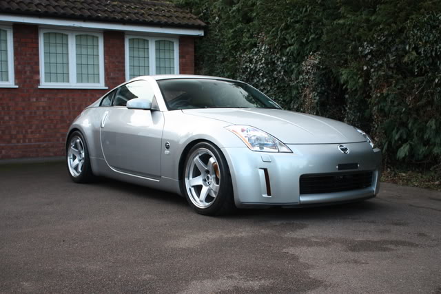

I kept mine relative in terms of front to rear lowering proportions. I used an image i found of the Nismo Z that had the ride height measurements on it. Cant find it at the moment but I think there was circa 3/4" difference front to rear (front being lower).
Incidentally I think mines to low at the moment (coilovers have bedded in and its got lower!) as the bottom is catching on speed humps and even on rough british B roads when going for it!
How mine looks-

looks great, like the wheels alot!
