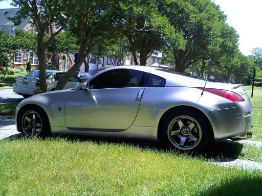

Ok got my wheels and tires on. Now it is time to lower my Z . I know two people selling two different types of lowering kits for 350z. I just want everyones opinion on what would look/feel the best. Keep in mind I have 275/40 and 255/40 on Rotas. Thanks

Do you care about the handling of the car significantly?
I just finished installing Koni sports, cut rear spring seats and Tein tapered fronts with new lower mounts. .5" drop and improved handling. If you are concerned more with looks, Tein S-tech springs on the stock shocks, or Tokico's, or Koni's, would be my pick.
The S-techs have decent spring rates.
