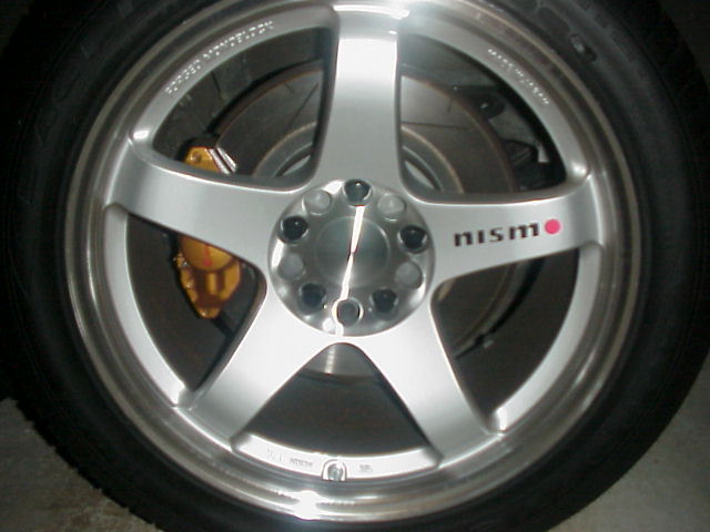

Mark, thanks for putting out a quality product. I love the look and performance of my slotted rotors!
