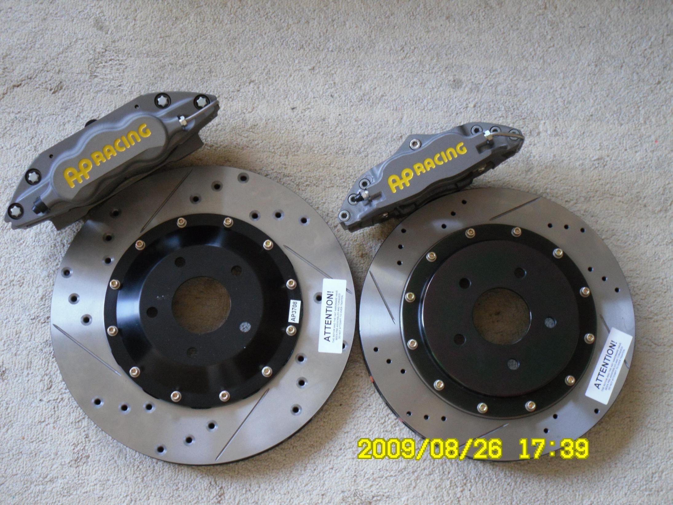

Default Got the BBK
Just received brand new AP Racing BBK in special competition grey color with 14.25" front and 13" rear discs. Will install them next week.

Congrats, looks sharp.
Very nice!

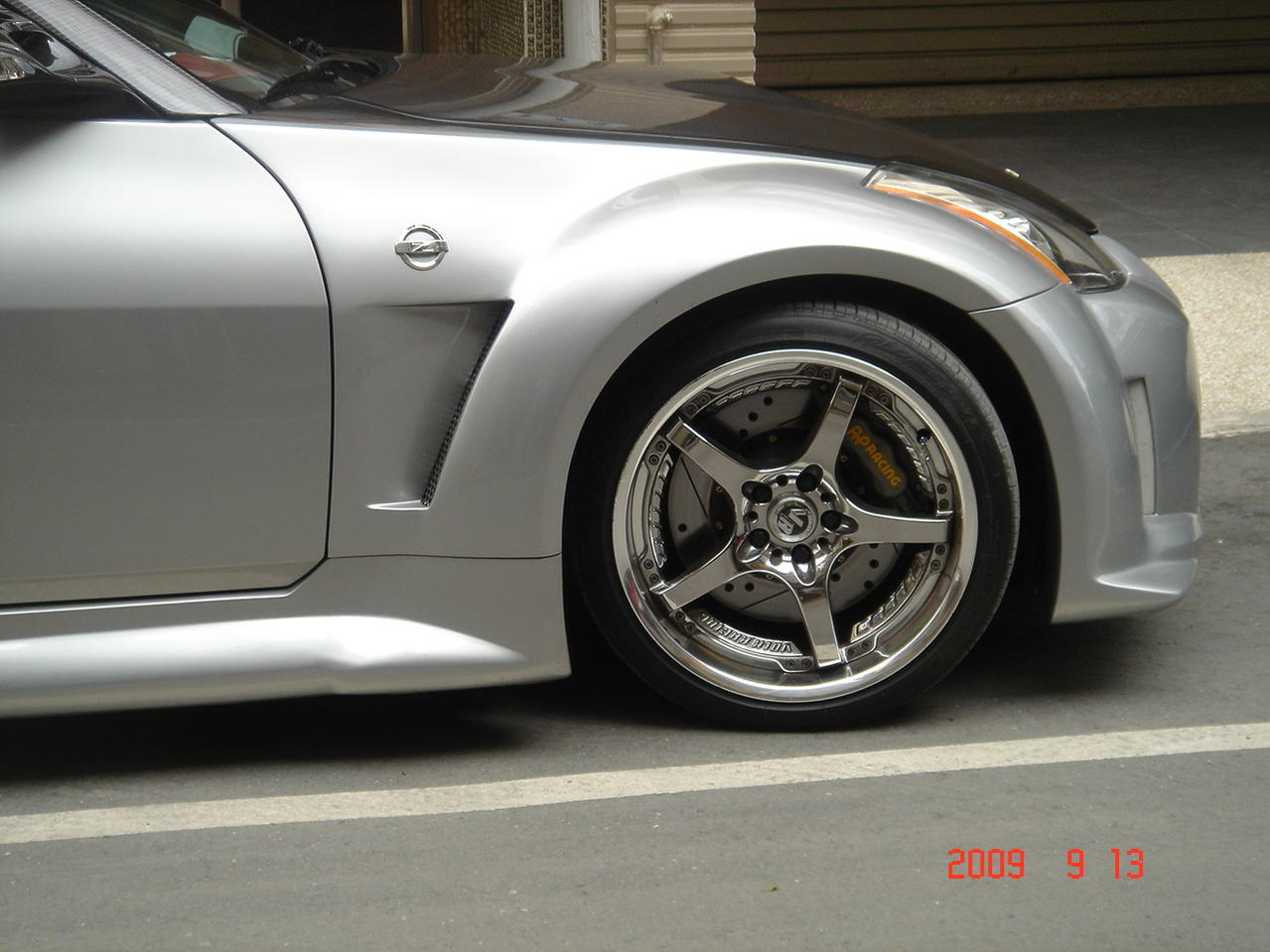

Installed finally.
Attached Thumbnails BBK Clears 19" SF Challenge?-ap-1.jpg   BBK Clears 19" SF Challenge?-ap-2.jpg
Old Sep 13, 2009 | 04:17 AM
TRYNALIVEPRO's Avatar
TRYNALIVEPRO
Posts: 2,306
From: ZOO YORK
^very nice, so did you have to use spacers???
Old Sep 13, 2009 | 11:09 AM
chsia's Avatar
chsia
Posts: 122
From: Far East
For the widebody, I'v already used 2-cm spacer for front and 5-cm spacer for rear. For added insurance, I added another 1-cm to front spacer. The AP Racing BBK clear the wheel spoke with room to spare.
