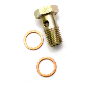

Yes, you need the bolt. The following is a picture of a banjo fitting with the banjo bolt (not 350z specific), which should give you an idea of how the brake lines connect to the calipers.
And just FYI, it's a special bolt, not something you can buy at Home Depot.

i have this bolt included with the kit..
i will speak with my mechanic again~

If your brembo calipers still have the factory hard lines attached to them that could be the problem. They need to be removed and the new brake line gets attached directly to the caliper with the banjo fitting like pictured in the posts above.
I'm about 99.99% sure that the stoptech brake lines are the same for both brembo and non-brembo brakes, so I doubt that's your problem.
