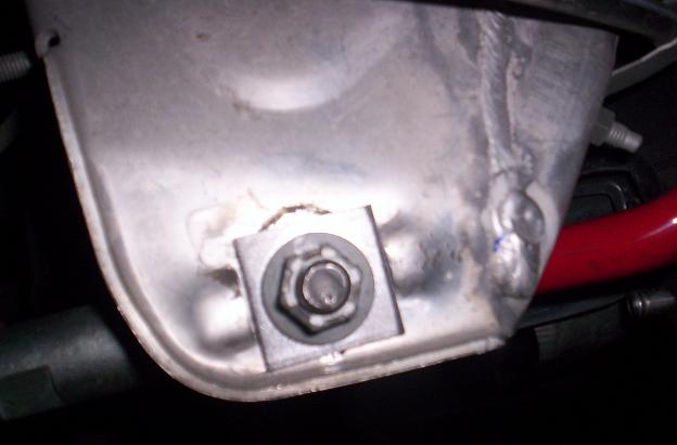

^ thats what im talking about...they are weak with the NOTCH thats in them........so "slip" is imminent...more so if your tech didnt torque them down good.....and at that, the nut has lost what we engineers call "bearing capability" as the threaded section is missing since the bolt itself is machined.....
see here - notice how the bolts are "half mooned" cut with a "flat" section on them!!
IMHO if you are running them, then you should mark them and keep an eye on them...
Mark eccentric washers like so:
I said screw all that once i got adjustable arms and made my own lock out washers:
Lock out washers with 10.9 "SOLID shank" bolt and square washer so no movement from that point at all.....all adjustment is done on my adjustable arm...
You can see more info on this thread:
https://my350z.com/forum/brakes-and-...alignment.html
