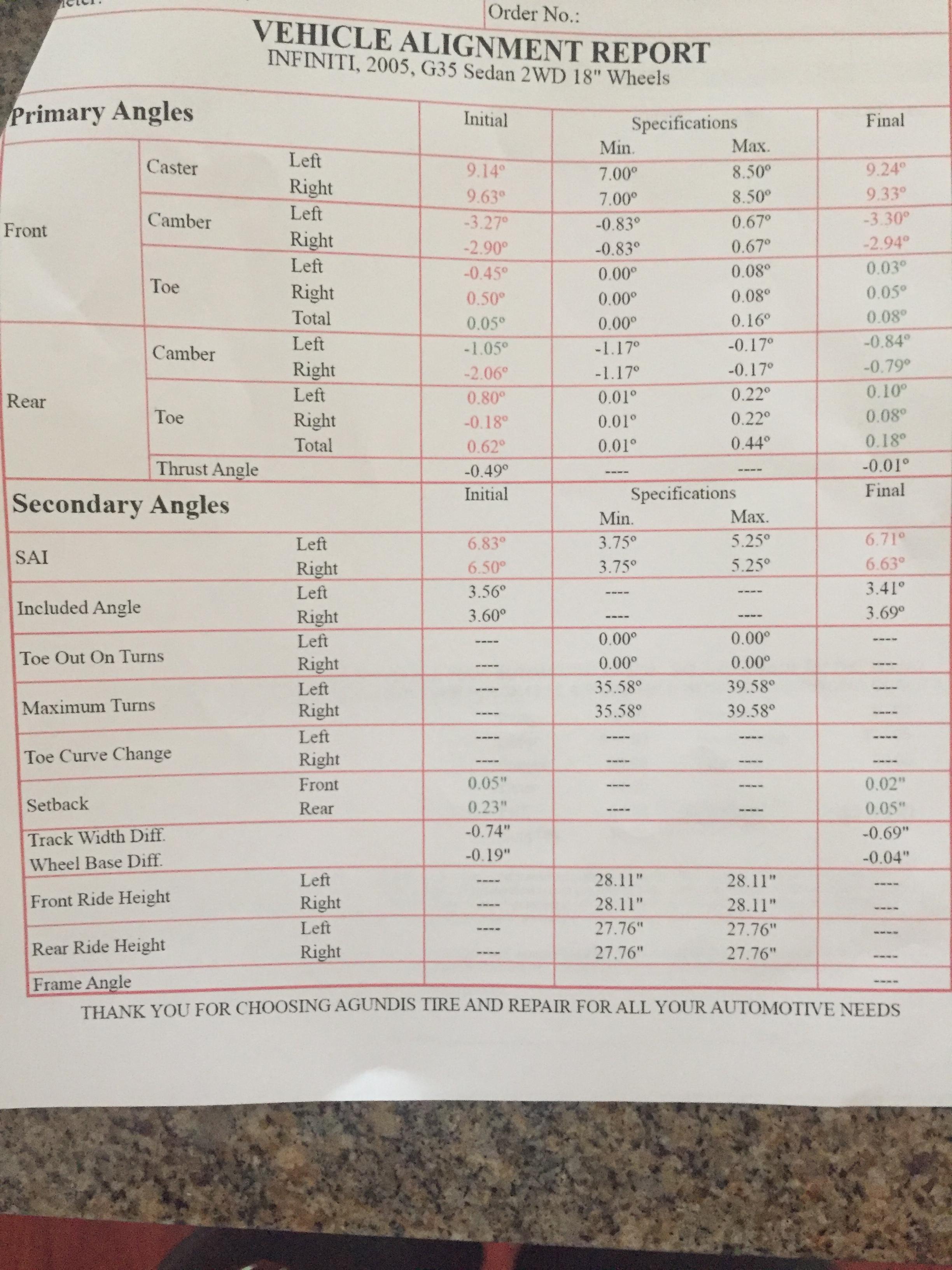

Hi Jason, was hoping you could shed some light on a few points for me as you're clearly the man with the answers here. I read your first few posts in this thread before taking on my suspension project and have to say, kudos on the excellent writeup, but I have hit some hiccups.
I installed BC BR Coilovers/SPC A Arms/SPC Rear Camber and Toe Bolts over the weekend. Didn't bother adjusting anything as I knew I'd be going straight to an alignment shop.
Unfortunately, realized after the install that I had been shipped coilovers with the wrong spring rates, 14/12k when I ordered 10/8k. I have BC DR coilovers with these springrates on the way, but I went to get an alignment as to not shred through any tire in the meantime.
I knew this was an issue, and I saw it first hand when installing, but there is no way to adjust the SPC A arms with the wheels on. The bolt on top of the balljoint is impossible to get to. Even raising the car up provides not enough room to work with. What have others done in this situation aside from paying for tons of labor $$$ to drop and reassemble the suspension on the rack? I'm thinking maybe some sort of angled box wrench, or removing fenders before going back? I'm pulling the current coilovers and replacing so anything I can do to "guesstimate" the right amount of camber while the suspension is out would be great.
Additionally, my caster looks to be out of spec, but the tech said it looks "good" so long as it's equal. Are these specs fine when lowered, or should I pull the A Arms all together and make some caster adjustments as well?

Thank you to any help you or others can provide!

What version of the control arms do you have, should be simple to dial out the castor

I have the adjust from the top version - model 72125
http://www.spcalignment.com/instruct...25-INS_WEB.pdf
Should I just pull them off and adjust to the -1.5* position on each? Or could there be some poor bushing play contributing as well?
Where are they set at now?
Then if you are looking for better handling, I would have it aligned to 350z or even G coupe specs.
They're set at 0 now.
Does anyone have any advice on adjusting the A arms on the car? I feel like this has to be a common issue with our cars. At this point I'm resorting to driving to the alignment shop with fenders removed. I guess I can have the caster adjusted by the tech at that point as well.
