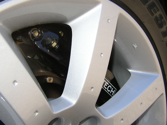

Yes, they fit. Replace the OEM balance weights with some new thinner stick on weights and mount them as close to the spokes as you can. A local Pep Boys GAVE me the weights.
