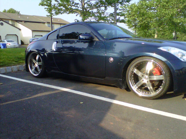

Thanks guys I just got off the phone with UAS and they confirmed it was the rear shocks have bump stops that you have to cut. I'll post pics when I get home but I have to say I love this kit so far.

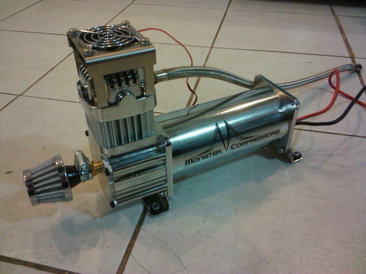

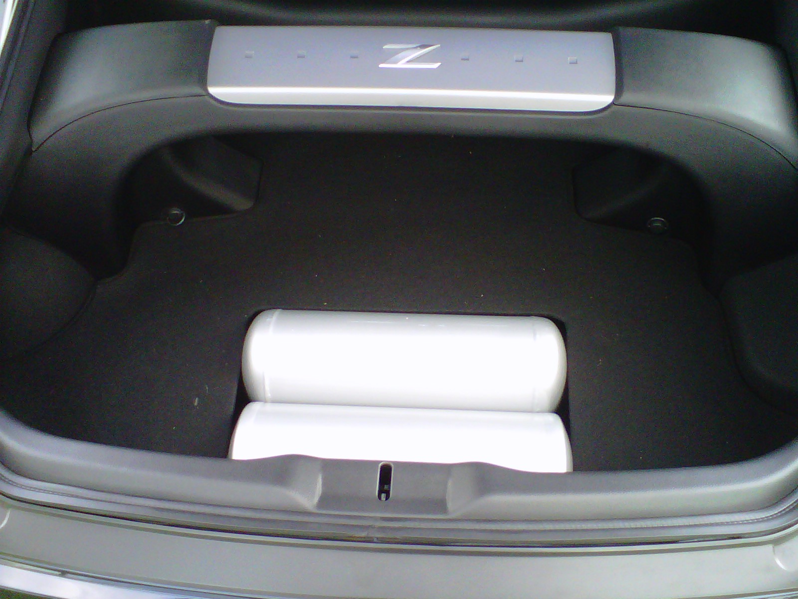

I ordered a compressor from my buddy he makes his own I'll post a pic filled my 5 gallons of air from 0-175psi in alittle over 2 mins. and 145-175 in a couple of seconds.

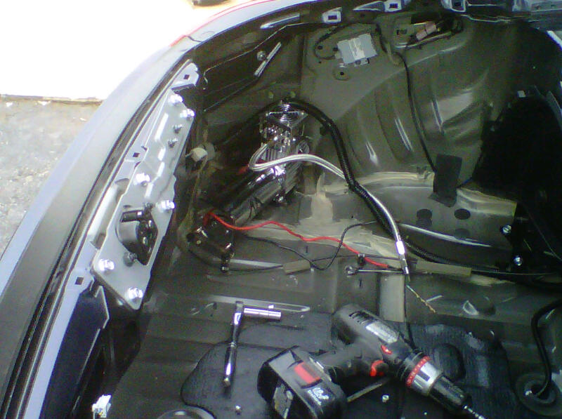

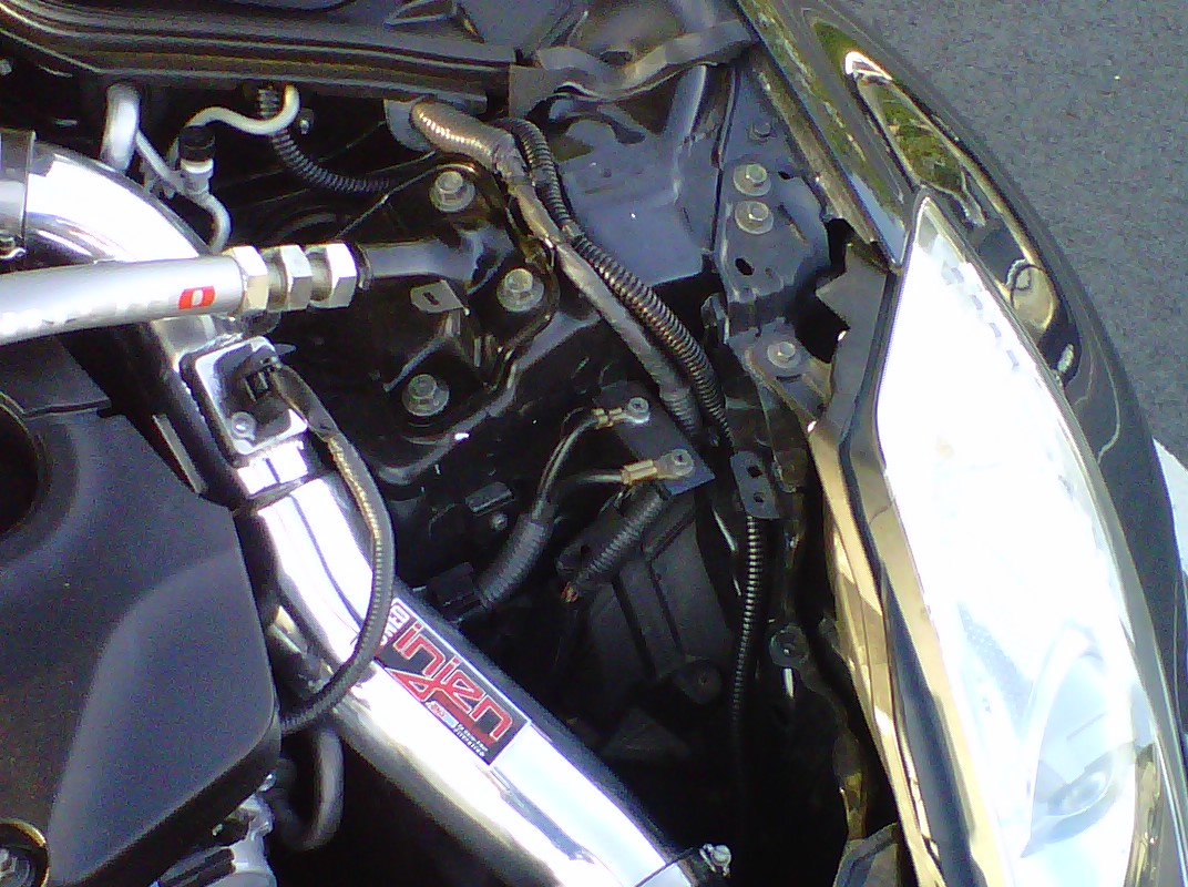

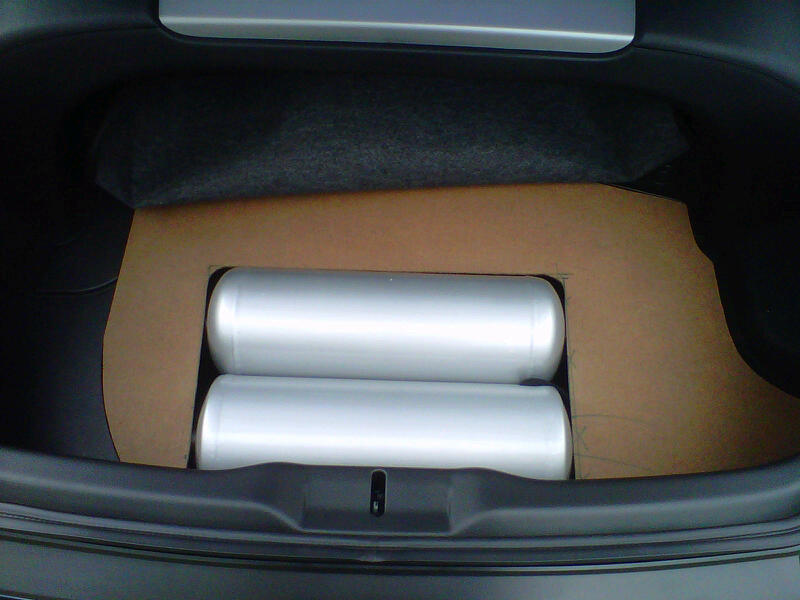

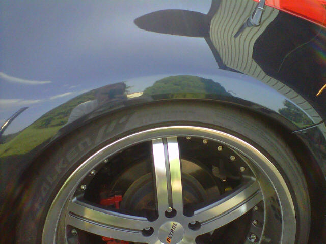

here some pics the last two pics are the before and after of the bump stops
Attached Thumbnails Air ride question-monster-compressor.jpg   Air ride question-img00258-20110522-1217.jpg   Air ride question-img00259-20110522-1633.jpg   Air ride question-img00272-20110530-1744.jpg   Air ride question-img00274-20110531-1804.jpg

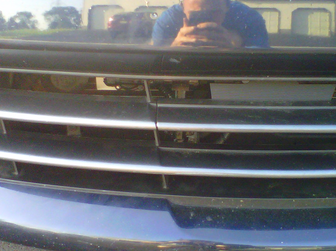

The rear is only done right now this weekend I'm doing the front and I changed all the fittings from push in to DOT compression fittings didn't want any lines blowing off
Attached Thumbnails Air ride question-img00268-20110528-1820.jpg   Air ride question-img00269-20110528-1845.jpg   Air ride question-img00270-20110528-1845.jpg
