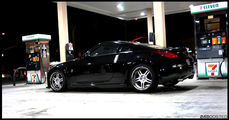

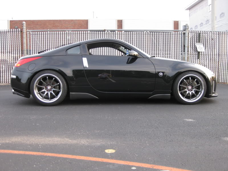

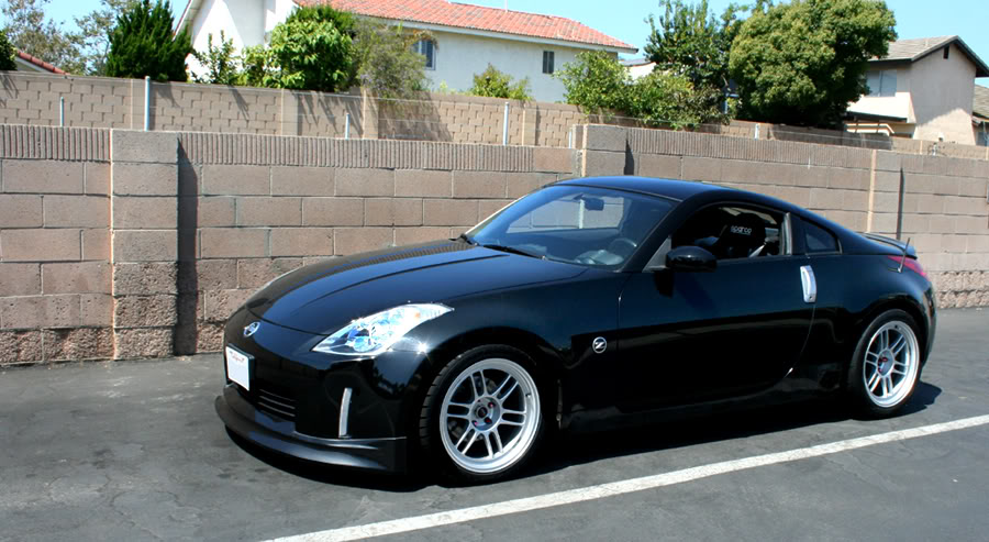

19x10+22 on 275/35.
18x10.5 +15 on 285/35.
Hotchkis has been around for quite some time and several members have them including myself. They ride a tad bit stiffer than stock but barely noticeable. Alignment will still be within specs. I wasn't happy with the drop and decided to change them to Tokico DSpec springs/shocks. Pics above are of them on Hotchkis springs only, stock shocks.

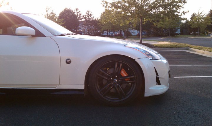

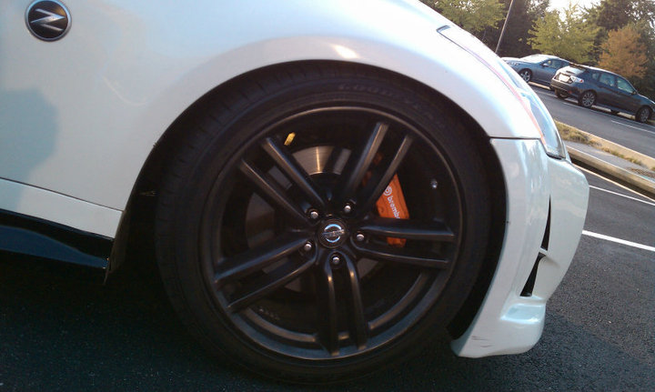

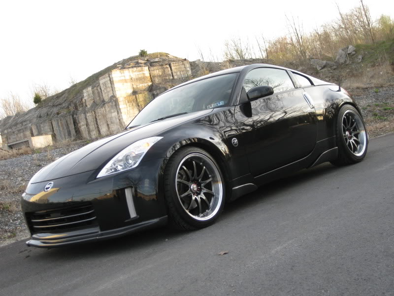

Here is a recent shot parked on a flat road with Hotchkis springs, 255/35/19 front and 285/35/19 rear tires. You can see more wheel gap in the front than in the rear. I'm looking forward to getting ride of these and stepping up to height and damping adjustable coilovers.
For the sake of achieving a good stance and getting the tires just about even with the front fenders, Hotchkis is not what you want. It's all personal preference. At the end of the day the thing that really annoys me is the performance first, and the aesthetics second.

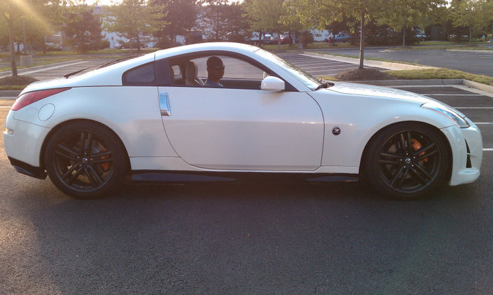

My hotchkis springs are awesome. I have the F&R sways and GT-spec bracing F&R. I don't know about the above poster, but my springs and stock shocks give the perfect ride height. I have 1 finger gap between the front and back. I also autoX and do very well...soooo. Check them out...

Looks good! Again, I'm just speaking from personal preference. But I should also add that I have not upgraded sway bars or added any other lateral bracing, so I imagine yours would feel and perform much tighter than mine.
Honestly if the front driver side wasn't so jacked up looking, I might consider keeping these springs and upgrading swaybars.
EDIT: For comparison, here is the same car also parked on a flat surface. The wheel gap is even front to rear on the passenger side.
Another thought: The car comes from the factory with more wheel gap in the rear than it has in the front. Seems to me that for weight distribution, the ratio of front to rear ride height should be maintained when lowering the car (assuming the aftermarket spring rates also vary in direct proportion). Meanwhile the Hotchkis springs lower the rear more than the front so that the end result is even wheel gap front to rear. That still leaves the car with some forward rake (due to rear tires are taller than fronts), but seems to me like it's not the f/r ride height ratio that Nissan intended. ( I may be totally off-base here...someone please correct me if so). Just my 2 cents.

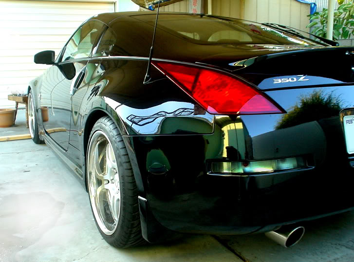

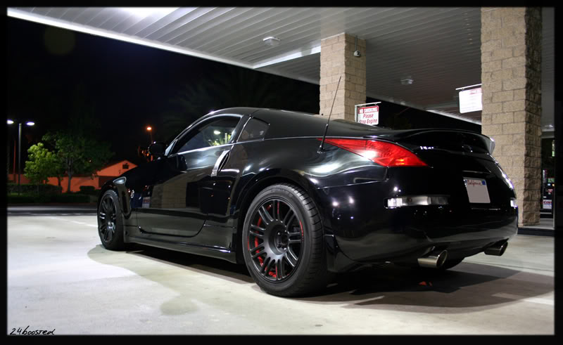

Found some more pics of my car when I had the Hotchkis springs.
