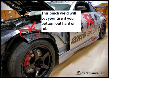

I am lowered 3/4 inch on the front and 1/2 on the rear. I don't know if its the fender or another piece but my front right tire bottomed out and got cut in the middle. The cut is nice and clean down the middle of the contact patch. The plastic fender cover is cut as well. Its a sharp piece of metal inside the fender behind the plastic cover. Can I roll it down and have no problems? I have made the dampening stiffer for now until i can figure it out.

It aint a bolt/screw cut junkster. Its to clean , like razor blade clean. I will try and get a pic. I searched and could not find another thread about it. This is one weird problem.
Update: Integra guys had a similar problem on lowered cars. This is the exact issue im having. Here is the link to that forum and the problem so if any of you guys get it this is the quick fix for it.

check Integra link foo... exact same prob. Pinch weld for the front frame rail cut the tire.

its the pinchweld inside the fenderwell. its right in the middle, itll probably be all shiny from rubbing on your tire. I just hammered mine flat.

How did the tire ever contact that ? The suspension bottems out well before it could make contact.
Thats what I was thinking.. but I have the exact same razor cuts in the middle of the tire too

Mine had a nut in the middle of the fender that I removed, it was also cutting into my tires whenever I hit a bump. I could tell it was the problem by all the rubber it collected from my tire.

I cut/ hammered my pinch weld out...
Slammed cars aren't running much tire

Ok finally got to fixing the problem. It was a very simple process. I bent the pinch weld towards the outside so that it would not hit the a arm when it goes up. Used a mallet and a bar of iron to make sure that if i missed i dint hit any other parts and damaged them. So far so good and got and extra 1/2 inch of non damaging clearance. Now my concern is if it will affect the structural integrity of my frame rails since I probably softened up some welds. If so would a set of fender braces do the trick? Couldn't hurt right?
