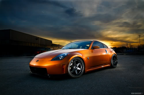

Default Coilover help!!!
Im not trying to track my car or do any extreme racing... Just want a good drop with camber adjustment for a daily driver 350z. Planning on spending $800-$1100 shipped. Plz help
I WANT MY CAR TO SIT LIKE THIS-

BC Racing BR series would get you to that height and meet the $1100 shipped budget, but you'll need to buy adjustable camber arms for the rear. Shouldn't need them for the front.
I got my BC coilovers from ImportImage in Florida. Look them up...they are a sponsor on here.

I dont want to go slammed but i want a nice aggressive ride. ive tried to do the research but everything is so biased. im looking for some hands on exp
