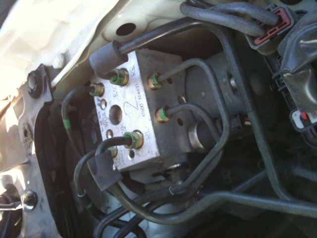

Here are two photos of my ABS unit. There is a lot of conflicting answers and I'm doing this to clarify for all. I've read other threads and people said disconnect the grey plug. There is also a picture floating around these forums where someone pointed a arrow at the ABS mount and that didn't make any sense at all.
Can anyone clarify this? If you look at the pictures the ride side would be the front of the car.

Finally got an answer from Jason Zya, and it is the GREY PLUG that I originally highlighted in the picture. I tested it the other day and brake lights still work.
