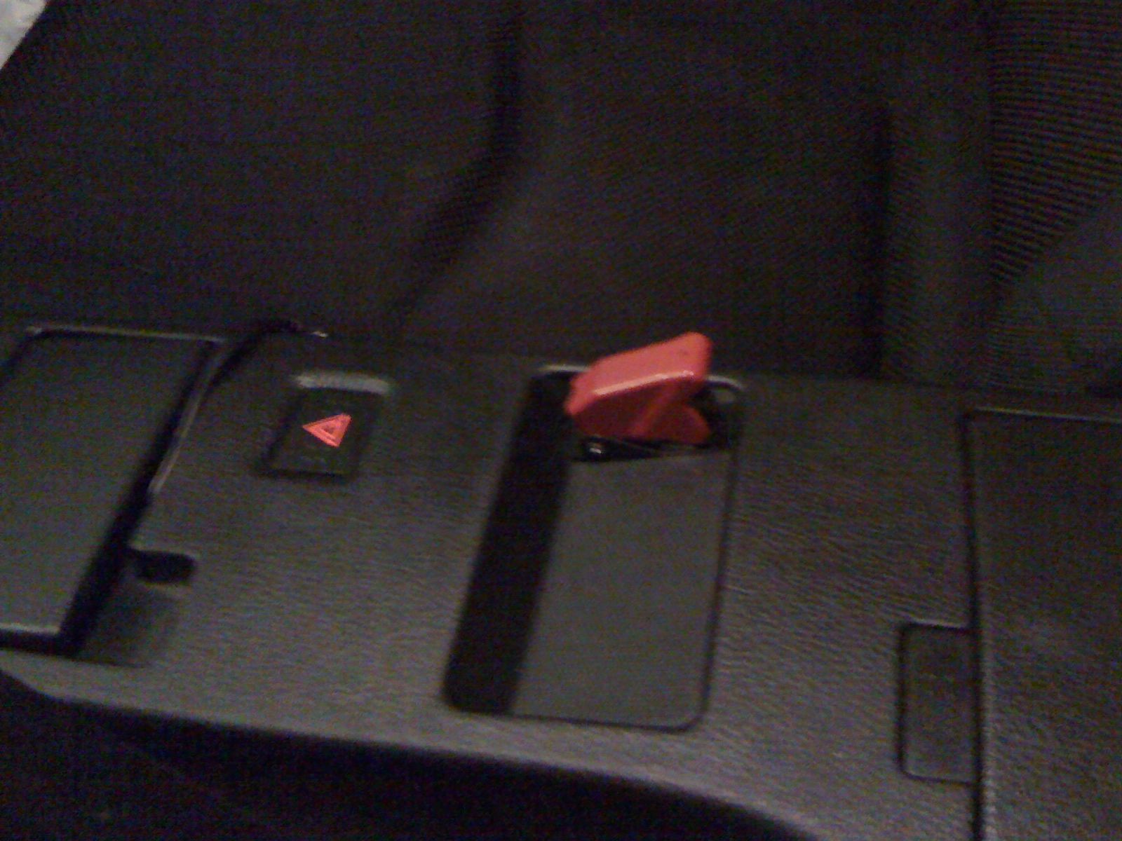

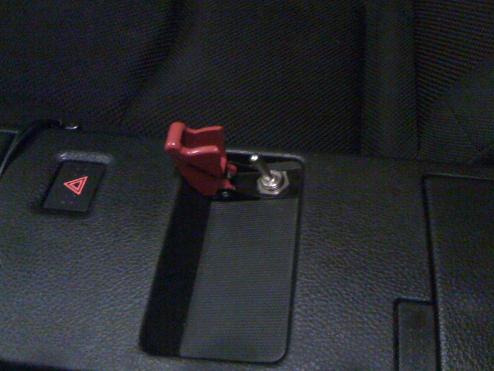

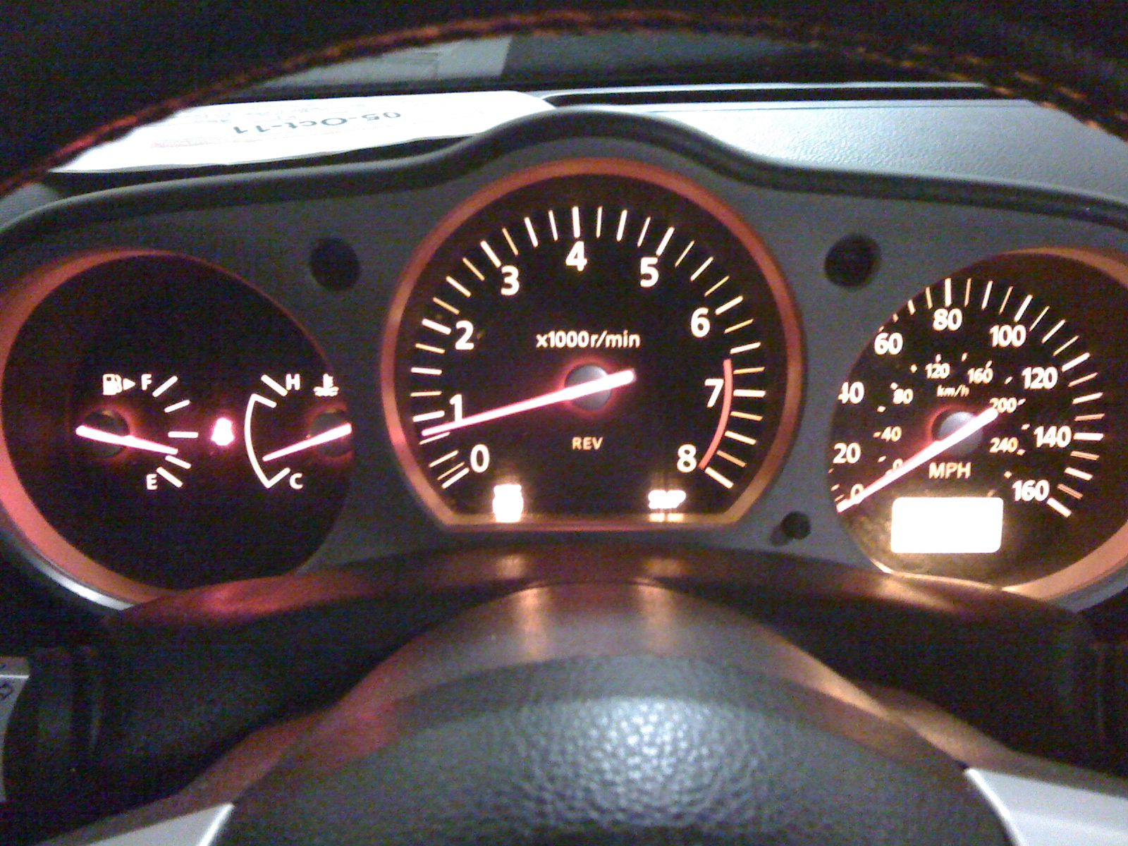

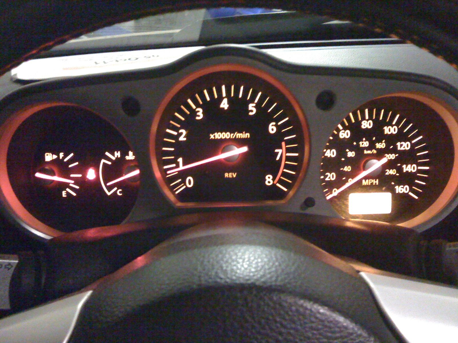

I installed a switch where the Seat Warmers are normally installed (I have Track Pack). Here is a finished Pic. For some reason, if you place the switch back in on with the car running the ABS light comes on until you restart the engine.
The only other way to fully disable the system without installing the switch is to spin-out just prior to racing/drifting at the track. Both lights will remain lit and the system automatically disables itself (Found this out on accident a time or two when I first started racing/drifting).
This mod is not that useful to those who don't fiet or heal-toe drift/rally - Other wise this is a huge improvement with regard to throttle response. I recommend this mod for track use only.
Decent writeup though, recommend giving details on removing the center counsel next time (Five Screws and two wiring harness').

Glad it worked for you. Sorry I didn't mention the center console details. I didn't think it was worth mentioning as anyone who can do this mod should be able to figure out how to get in there.
