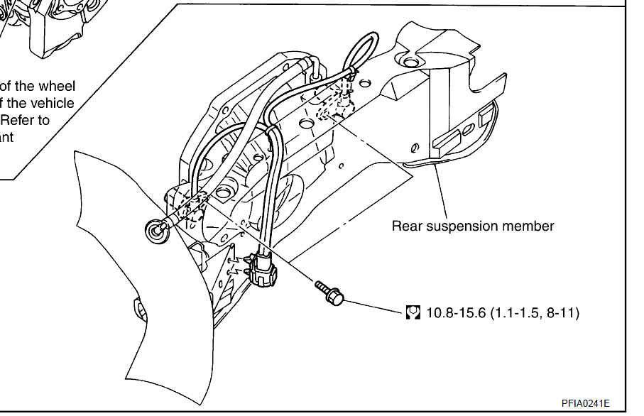

Hey guys, where can I find the rear ABS sensors? I need to clean them. Merry Christmas!

they are on the pumpkin.

So its on the pumpkin which is part of the LSD. Is it visible on the from underneath the car or do I have to open the diff ?

The pumpkin is the rear diff. The sensors are mounted on each side where the half-shafts connect to it. Look for wiring down to the sensors.
