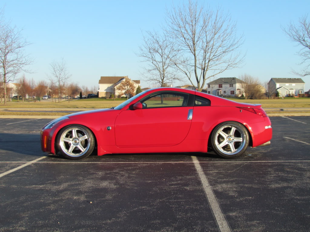

with that being said, i had the eibach sportlines springs. the drop was nice...but i hated the ride.
i switched out to coilovers and went with stance gr+. night and day difference...and you can adjust to whatever height you want. i would never go back to springs and i say save up and buy coilovers from the start.
here are some pics for reference.
eibach sportline drop:
it rode "ok" and was tolerable...but i wanted more adjustability and wanted to be LOWER.
Stance GR+:
ultimately its your money and your decision, but in the end...its worth getting coilovers in my opinion. buying the a-arms and camber arms is just part of the game. you're gonna have to buy them if you want your camber within specs.

how much drop on the eibachs? it looks really good!

Originally Posted by BSERIEuS
i agree with this completely and also adding to this, you might as well do it right the 1st time, otherwise you just end up spending more money.
Damn....That actually looks PERFECT! I'm a ride and handling freak, so I love my Nismo S Tune set up.. but it's only 3/4" drop as you can see here...
009-4.jpg?t=1318383780
I would love a drop exactly like your Eicbachs, but handling and ride would not be to my liking. Clearance issues also can be a pain.
