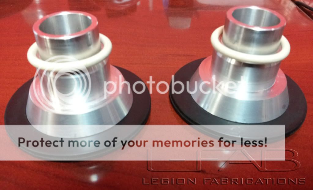

SPL recently started adding a o-ring with their Compression Rod Bushing Set.
Looks like it would get rid of most knocking noises coming from their spacers hitting the bushing's race.
We are currently working on machining the SPL spacers and experimenting with rubber washers to help further reduce road noise and allow a greater amount of articulation

The modified SPL compression rod bushing I mentioned before in other threads, kudos for doing it....
the pic you have looks god, did you machine a full up completely new part, or machine down the existing cone to that shape?? it appears you machined down the cone it comes with.
From there i would just monitor it for cracks...
oh, the rubber washers is a nice idea!! between chassis and cone, and underbrace and cone.
