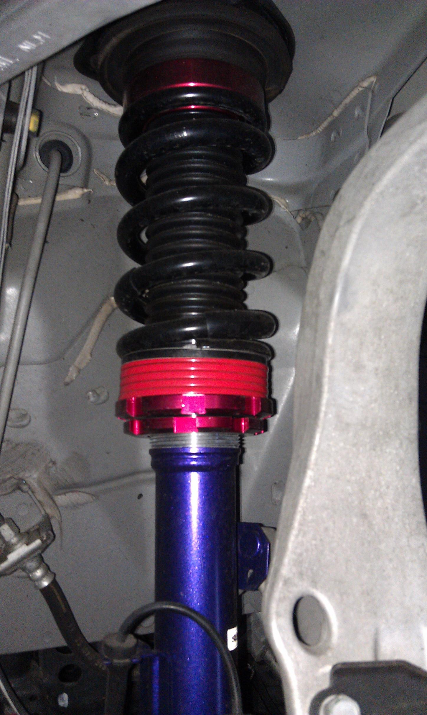

Does this setup look correct? The helper spring on the bottom and very tight? I don't see the point of a helper spring if its that wound up.....

Also to answer the OP's question, helper springs are not meant sustain the weight of the car, (they are usually rated at 1.5kg/mm), and therefore as soon as you lower the car onto the ground, the helper springs compress completely as you can see in that photo. The helper springs keep the spring from moving around when the suspension is unloaded, minimizing noise and slightly preloading the main spring. If the car in your photo is off the ground, it looks like you have the coilovers set pretty much max height, at that point - as there is no more outward stroke left in the damper and therefore no room for the helper springs to extend, they are simply acting as a spacer.
