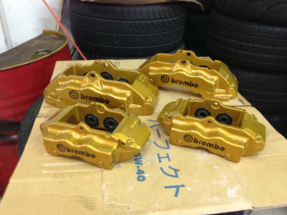

I wonder how much you spent to re-paint your Brembo? I spent like average US$100/piece total around US$500 to re-paint my four Brembo Calipers!!! And yes wondering if this calipers fit in an 18" rims?
