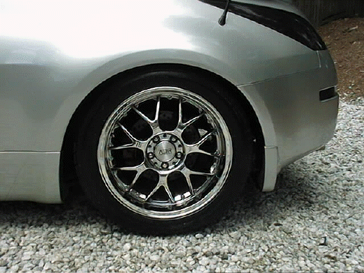

I have them on my Z, Install was a cake walk, took under 2 hours. The ride is slightly bumpier than stock but i preffer to feel the road and you will with these. Overall they are the bomb! the car handles better than stock. heres a couple pics. Overall I have lowered 1 1/2"

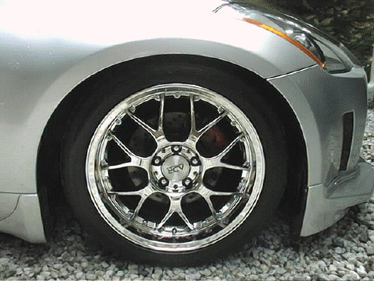

another

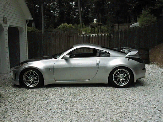

one more

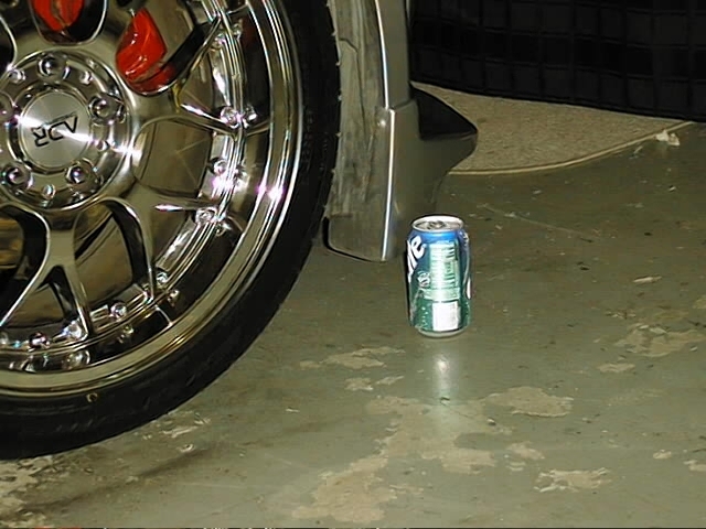

rear
