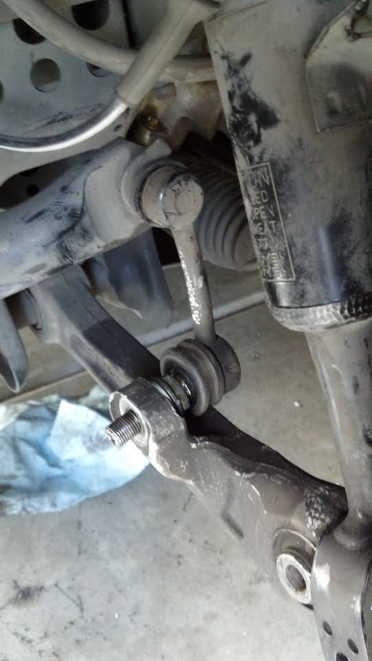

Ive never encounter this on my previous coilover install. The end link got stock, has anybody experience this and found a solution.

Picture?

Default Here there are.

I found the easiest way to deal with the end links was to disconnect them from the transverse bar (at the bottom), take the anti-roll bar completely out of the car, then work on loosening the end links on a workbench.

It is because the bar is still loaded, the side you took the pic of , jack up the suspension slightly from under the spindle till you can slide the end link out.
This...

Thanks Guys, problem fixed. What is the benefit of upgrading to those Links?
