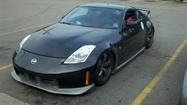

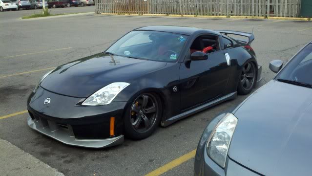

Thanks, I just wanted something until i decide on a coul over to use. they have around 15-20K miles. I believe hes on here.

oh//// so that's how you ruin a nismo

So he degraded his nismo? Good thing your car will be done right

buy the shocks and then buy the car so you can rescue it from further torture.
and why is his 350z emblem on the wrong side....?
