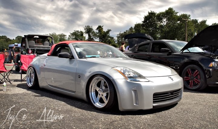

If you get OEM style coils there are a couple things you can do if you want to go lower first is dont install the rubber spring mount or cut it down. Second thing you can do is remove the adjustment collars for the rear spring. I have done both and am slammed on ISC N1 coils but if its still not low enough for you than you should have gone air.
Since everyone has a different opinion of what low is here is a pic of my Z.

yeah, remove the locking collar for more drop. z on t, i dont know why yours is like that. maybe something is wrong with your suspension arms.
