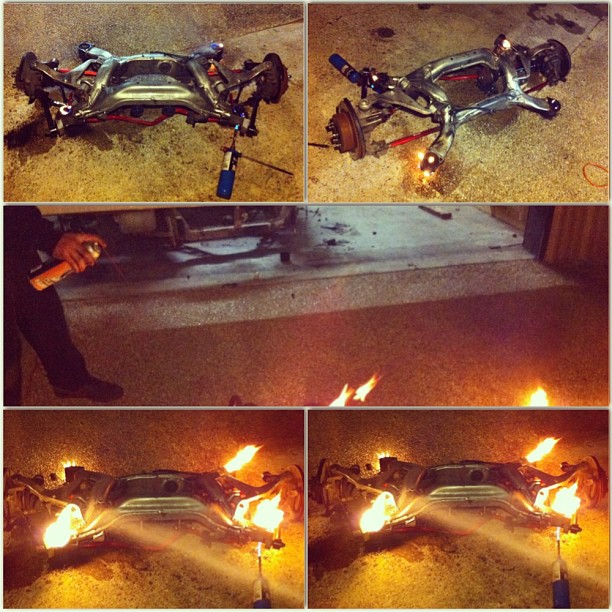

thanks for the input, i've decided to just change the shock mount bushings to save time because i have to wrap this up before jan 13(next event), the other bushings on the knuckles and front caster arm isn't that terrible and the rest of my arms are spherical bearing aftermarkt so im sure i'll be good. I'll save doing the rest for summer or when i have more time.
Originally Posted by go7roo7
Never done this on a Z. On the 240's you burn those suckers out with a blowtorch.
yep, im a long time 240 owner and thats what we do, and thats what i did
plus it kept us warm; we dont have a shop heater'
