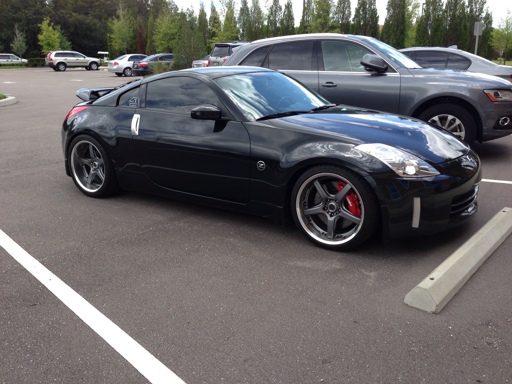

I think I only paid like $1300 for bc coilovers installed with ride height setup. I had to roll the fenders, though.
Wow perfect drop
