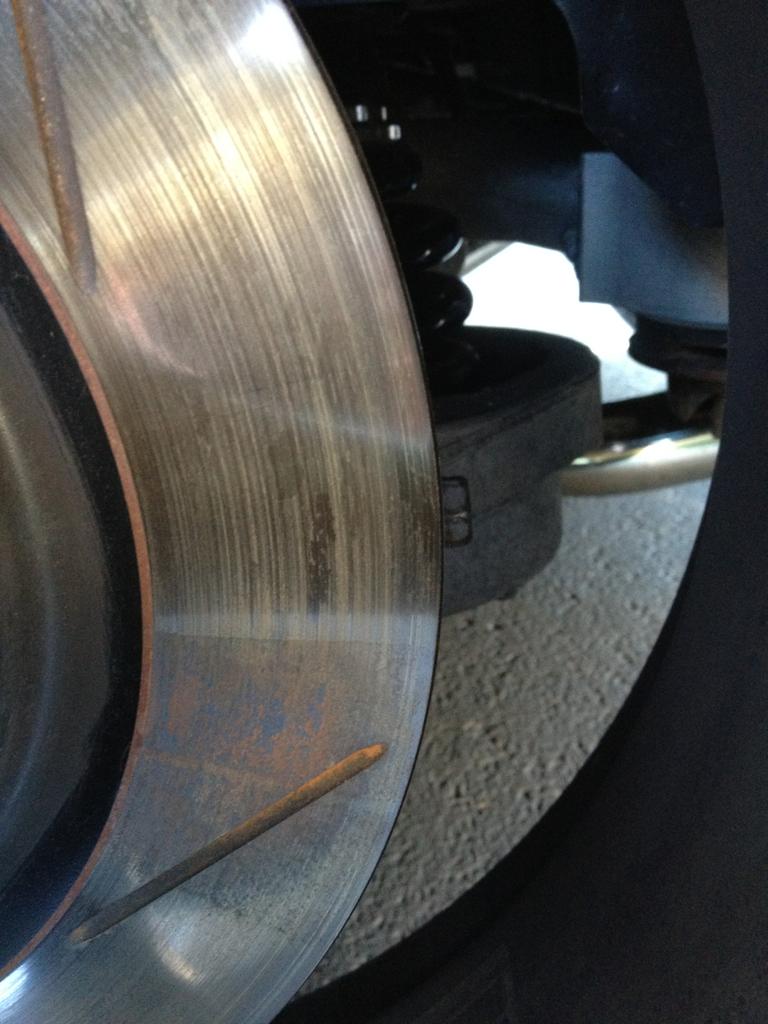

I tried to get a good picture of the blemish / rough spot that is on the rear driver side rotor. See pic below, specifically the orangey rust-colored area near the slot at the lower right of the rotor as pictured. Any clearer idea of what's going on?

That is pad contact with rotor just as we thought, try to get it refinished

This shouldn't be too difficult to sort out. Try taking your Z to a shop that can check rotor run-out and turn the rotors on the car. That should be sufficent to remove the pad residue, but as others have said, you may need to use a light sanding on the pads themselves to bring them back to full effectiveness.
BTW- it wouldn't hurt to have the shop do a power brake bleed to make sure you have fresh fluid to all four corners and no air trapped. Use a good quality brake fluid like ATE Super Blue or Gold 200 and those Brembos should feel and stop great!
