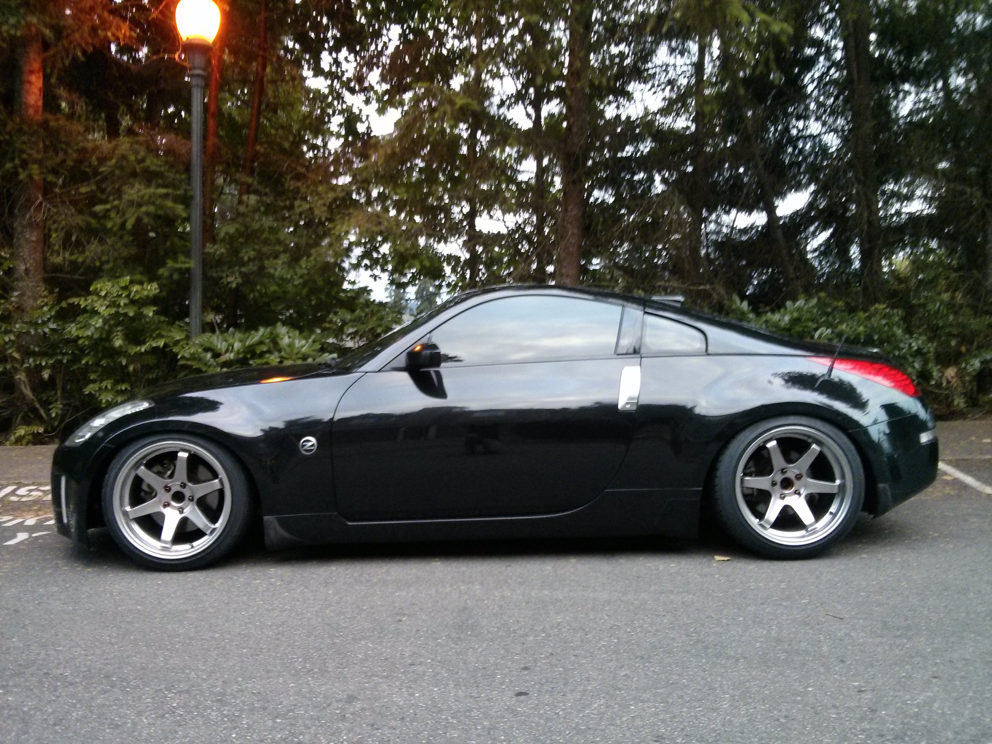

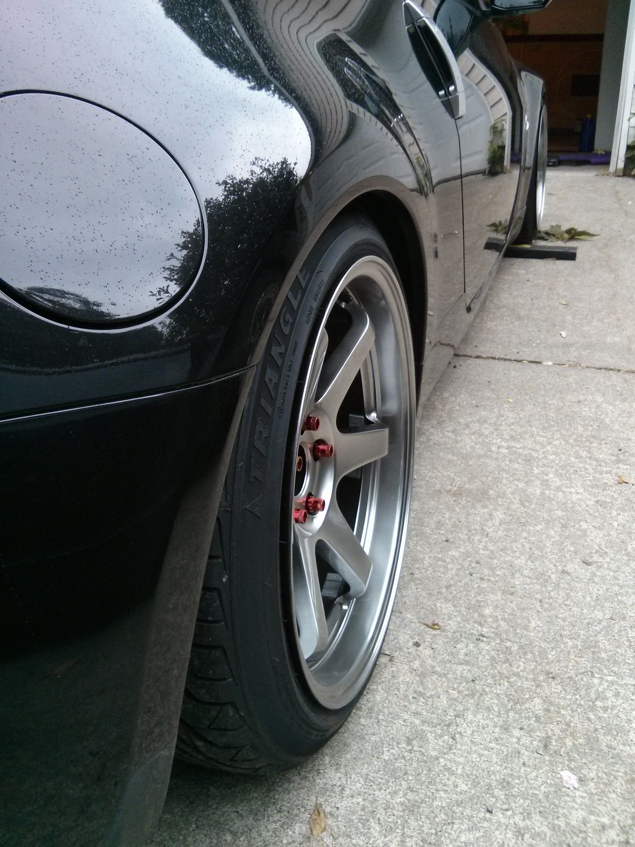

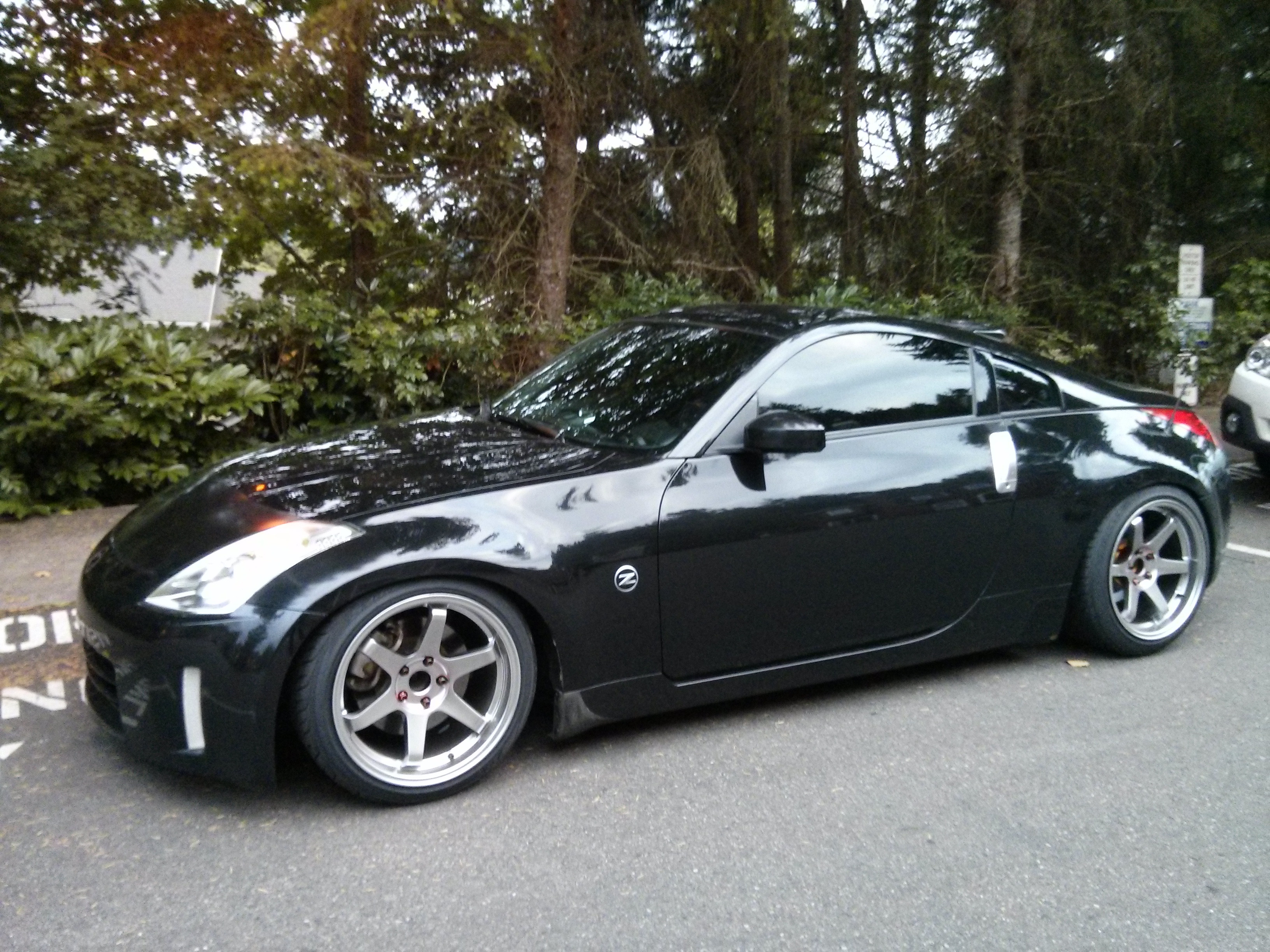

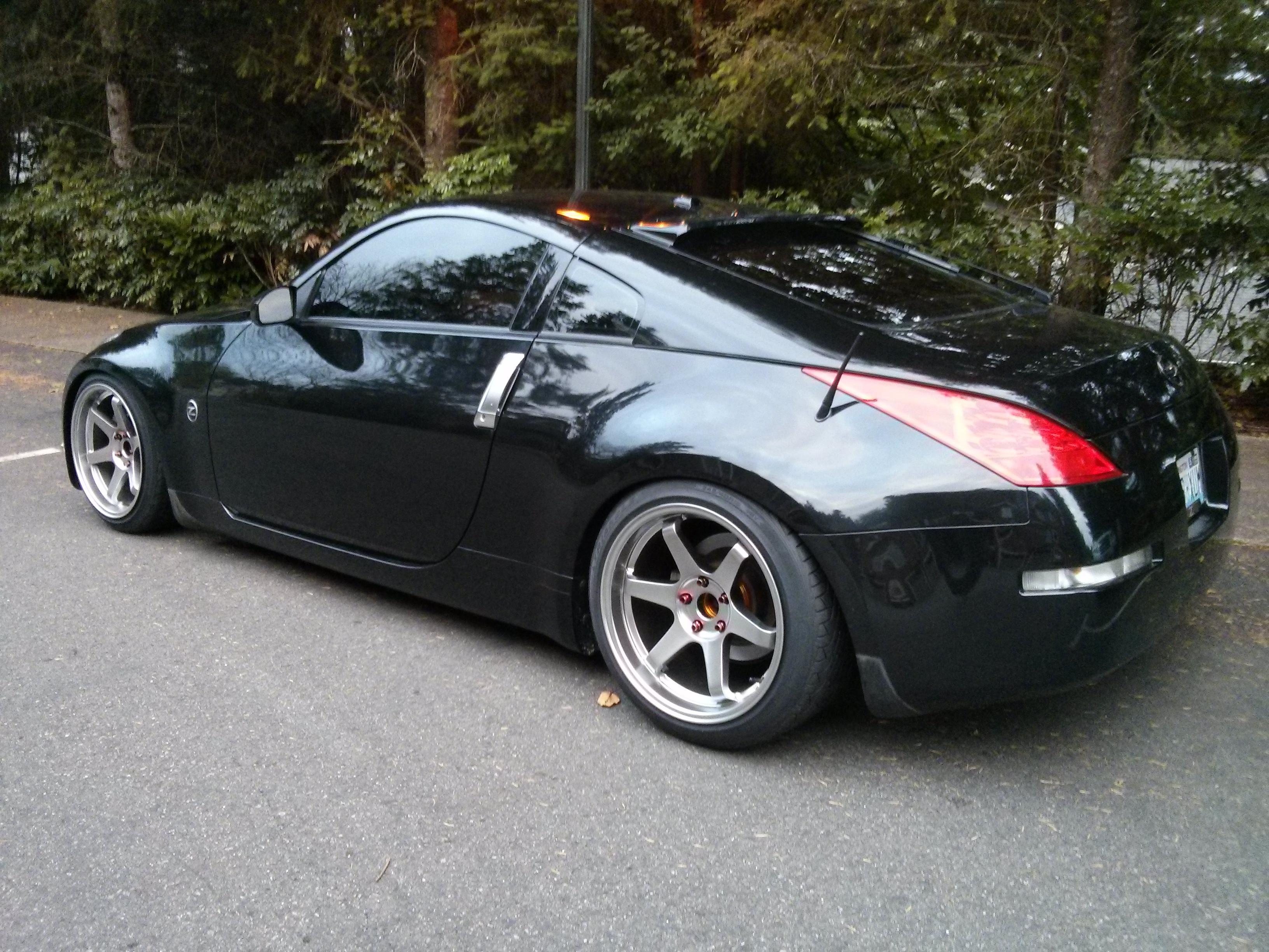

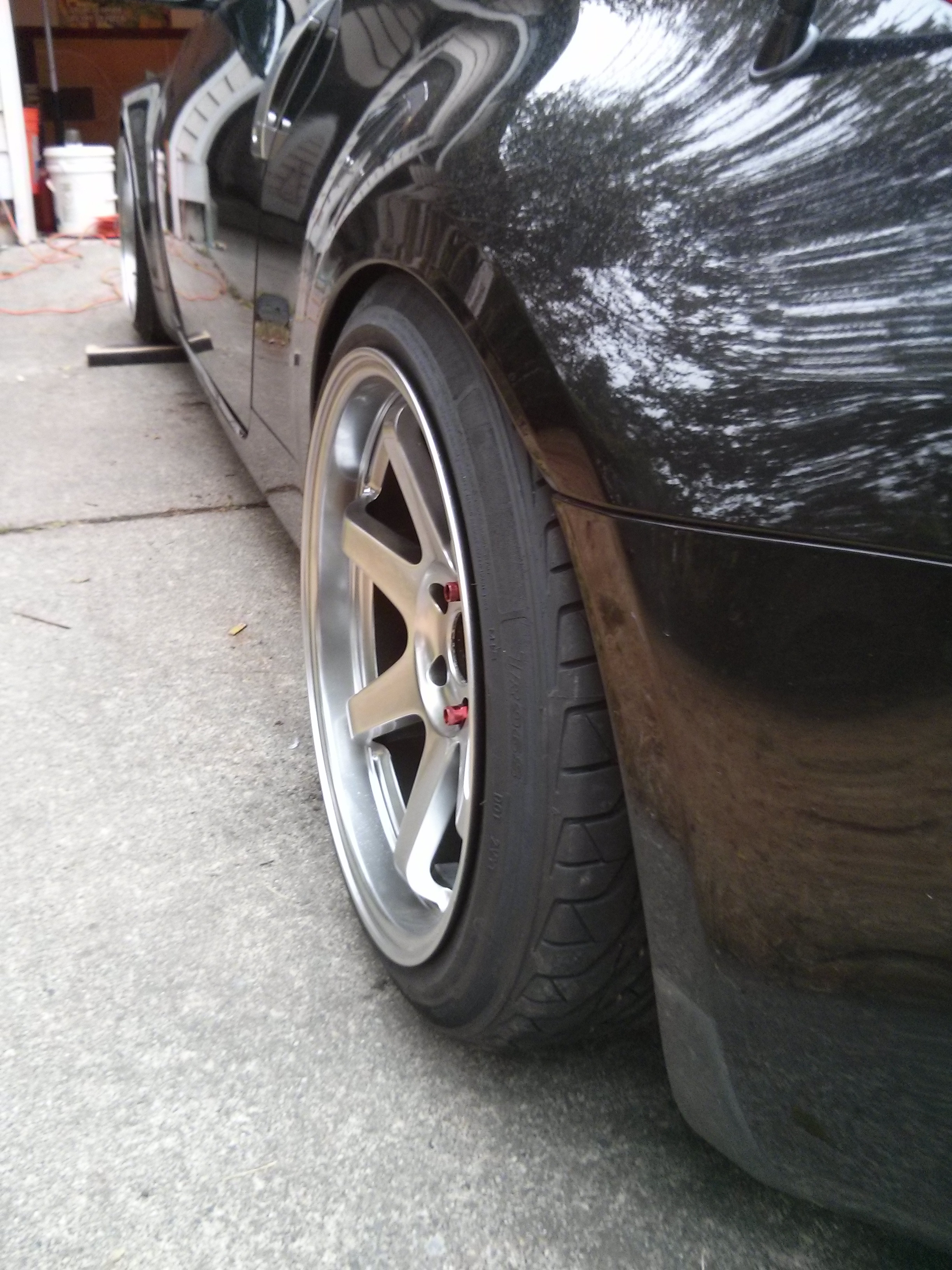

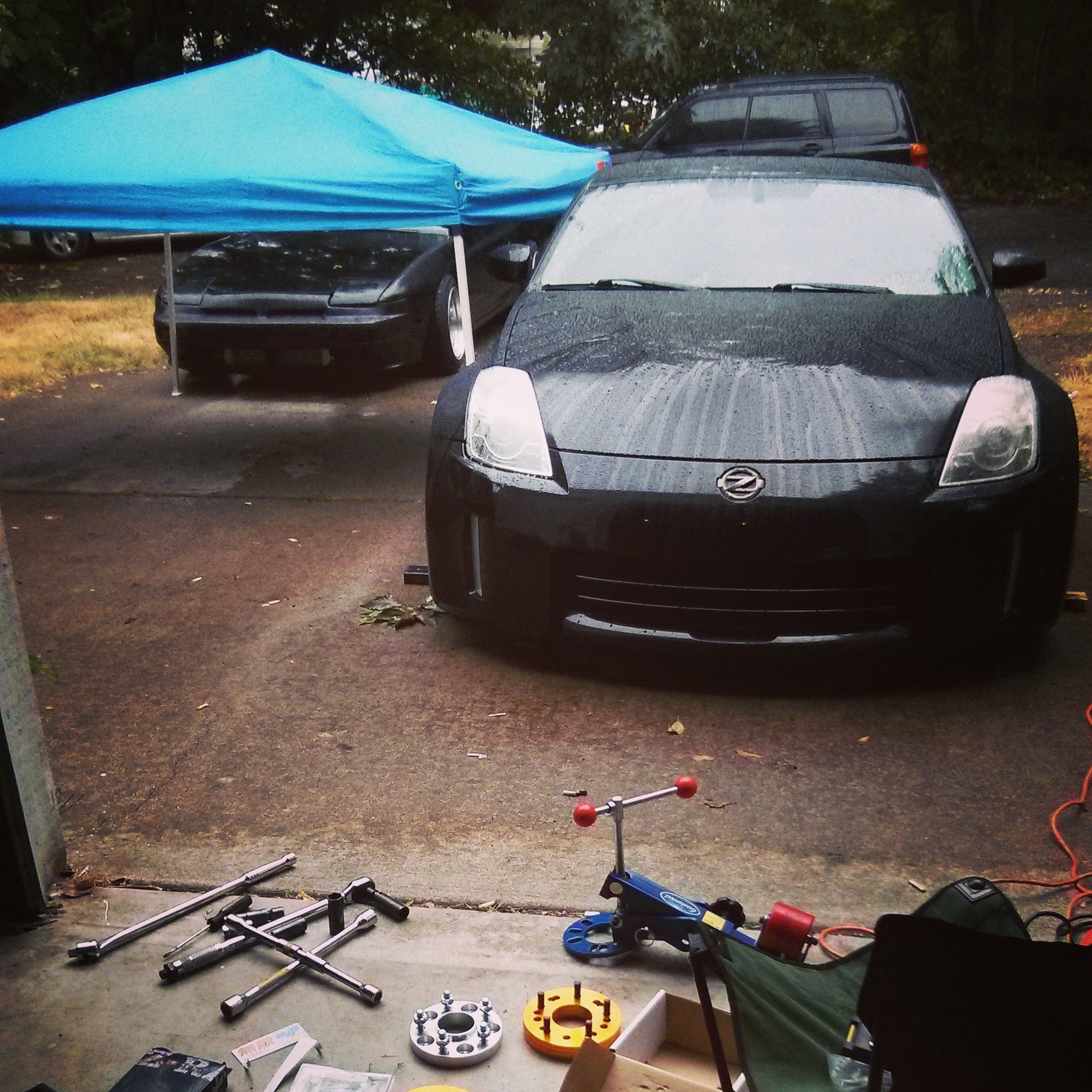

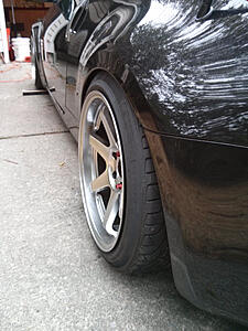

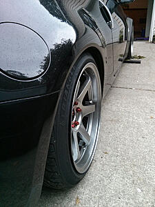

Got the parts on last Saturday!
Before rolling and 27mm of spacer

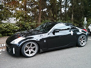

After
The gap in the rear will be closed when I get an alignment. It think its sitting between -3.5 and -4 right now and I want to bring it out to around -2. The fronts are to receive 23mm of spacer after rolling.
Impressions of the coilovers. Best set I've owned yet! I've had AGX with Swift Springs, Megan, Tein, Stance, H&R, Ksports, and PBM Comps in the past. Cars include 86, x8, DC5, S13s, others. This set is only beat in comfort by the H&Rs but beats them in adjustability. The damper feeling in these things is great, just like the Comps I had on my S13. Because there is only 12 clicks of adjustment you can actually tell the difference with each turn. Right now I'm running all corners at 5 clicks. I may take it down to 3 for street driving. I can definitely say the Pros are worth the money over Comps if you'll be driving this day to day, not as harsh as Comps. I actually found myself bottoming out on driveways not being careful because I forgot I was on coils driving around town.
As for the install it went about as planned. Be sure to get a #114 or 115 dremel bit for the toe bolts or else that will take forever. I somehow managed to mess up the preload in the front and leave an inch of wheel gap even though I thought I was at max low but was able to sort it out. Final ride height is 9.5cm to front pinch welds and 10cm to the rear. Front coils can go down about 1-1.5cm more, rear can go down a lot more.
