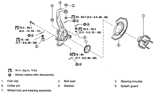

Front hub hmm didn't think of that since i didn't have any play on it, are you referring to #3 or #7 in the pic?

Ya most likely your wheel bearing is worn out...it is #7 in that picture, very easy to install it comes as one piece you take off and bolt back on. They are like $200 each for OEM, aftermarket even cheaper, if you can do brakes you can change the wheel bearing.

Great thanks guys! looked at a DIY and it looks way to easy , looks like i got something to do saturday . Thanks again!
