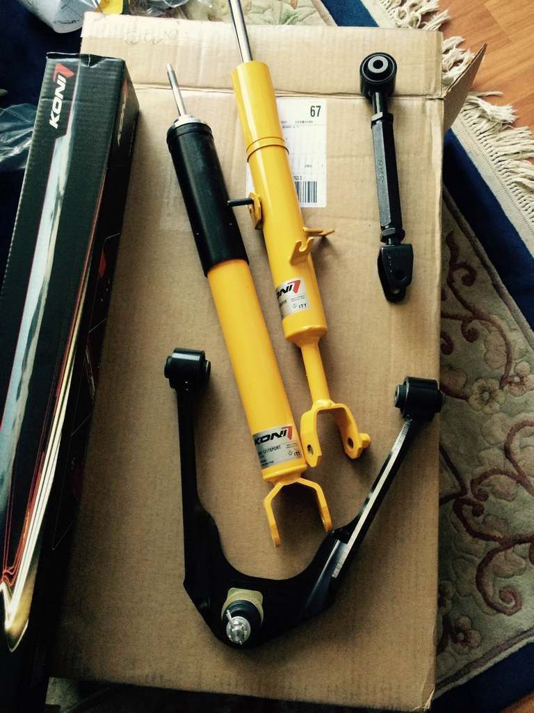

Absolutely! Wasn't sure how the Bilsteins would do on our Z's - my experience with them were all on my Euro cars (Volvo, BMW, Benz) but happy to report, they've been great! (That's why I want my son to have 'em on his. He was going to go budget, being a college student and all (junk shocks, no names named) but I told him "Dude, your dad is an exacting and **** retentive car-o-phile..... and good dads don't let their kids drive on junk!"
Funny, I didn't hear him complain at all. (And even though he was going to buy his own springs and such, I just decided to get those for him as well...)
Besides, I've not run Konis in MANY years (last car I had 'em on was my racecar and on a 240Z) so I want to satisfy my curiosity. Even if they don't work as well as the 'Steins, I KNOW they're not the junk shocks my kid was going to get. Oy...
I'm having them installed professionally next week since my whole new set up (camber adjustment stuff) is requiring an alignment and I can't do that. But aside from bringing camber back into the middle of nominal range, my bars will remain as they were and the shocks will start out on mid-firm and I'll dial it in from there.
Oh, and if you do go with the Hotchkis springs, I'll be very curious how that will work out. I debated on going linear but I've been using Eibach Pro Kit successfully since the '80s and really like them for the way they ride and perform when needed so. But am curious because I'm betting the Bilsteins will take the edge off the linearly firmness of the Hotchkis units.

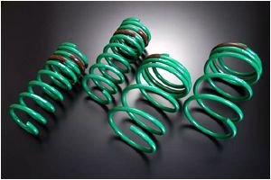

Right now I have the Bilsteins with Tein S-Tech Springs, and the ride is comfortable with very good handling on city streets. I would say that the Tein S-Tech Springs are a hybrid progressive/linear design.

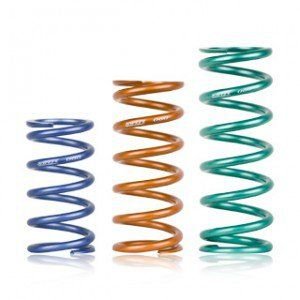

A typical linear spring (Notice that the coils are uniform)
A typical progressive spring (Notice that the coils are wider at one end)
Hotchkis Springs (Notice the coils are uniform indicating a linear spring)
Tein S-Tech Springs (Notice that coils are not uniform but more tight than progressive)
The Tein S-Tech Springs are somewhere between the typical configurations for linear and progressive springs. That is why I define Tein S-Tech Springs as hybrids.
ADDITIONAL NOTES: Linear springs – aka Straight springs, have a spring rate that is consistent along the entire length of the spring as it is compressed. Progressive springs on the other hand, have a spring rate that increases or changes with the compression of the spring.

I'd be interested to see some data on how many of these progressive springs are actually coil-bound at normal ride height, effectively making them a linear spring. It's my understanding that some manufacturers (Swift, to name one) do this to keep the spring in the seat at full damper travel, since the stiffer/shorter spring is often slightly too short for the shock at full droop. The progressive portion becomes, in effect, just a helper spring.
Originally Posted by spike100
I think (but am guessing) that a superior shock (such as the Bilstein) will mitigate (but not completely eliminate) the harsh ride you get with linear springs (the Hotchkis springs as an example).
The harshness is largely in the dampers to begin with, not the springs. None of these springs are considerably stiffer than stock (which are linear). The harshness comes from poor high speed damping, which tends to transmit even the smallest bumps into the chassis instead of soaking it up like the dampers should (overdamped as opposed to critically damped). Bilstein is probably the best in the world at tuning high speed damping. You should be able to increase the spring rate without gaining harshness with Bilsteins. I'm getting anxious for mine to show up, but they're probably sitting in one of those container ships parked off the west coast.

Interesting thought Kilogram but a true progressive spring is NOT coil bound at static height (or at least it's not supposed to be). With Eibach, for example, when the car is at rest and with the spring fully weighted (with 25% of the theoretical weight of the car sitting on it, the gap in the soft end of the spring is still visible. Again, "at least it's supposed to be."
However, what you suggested does exist. Take a look at a square end spring and you'll note that it appears that the last 10% of the spring's length appears to be coil bound but that's intentionally done for the exact reason you mention, to give the spring the proper curvature to remain in full contact with a flatter type spring perch.
