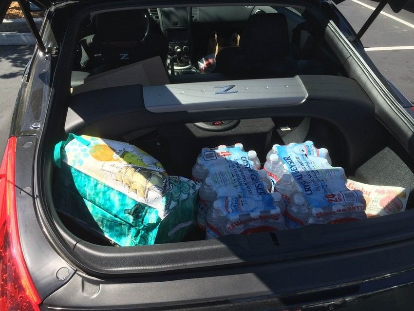

Ahh, yes, maybe that's where I've seen it.
Can't fit 'em in my Niz anymore.... P.O. laid a sub-box in the cargo area. Z'OK though, I can still get my groceries in....
No, I'm not in trouble with my wife; why do you ask?
