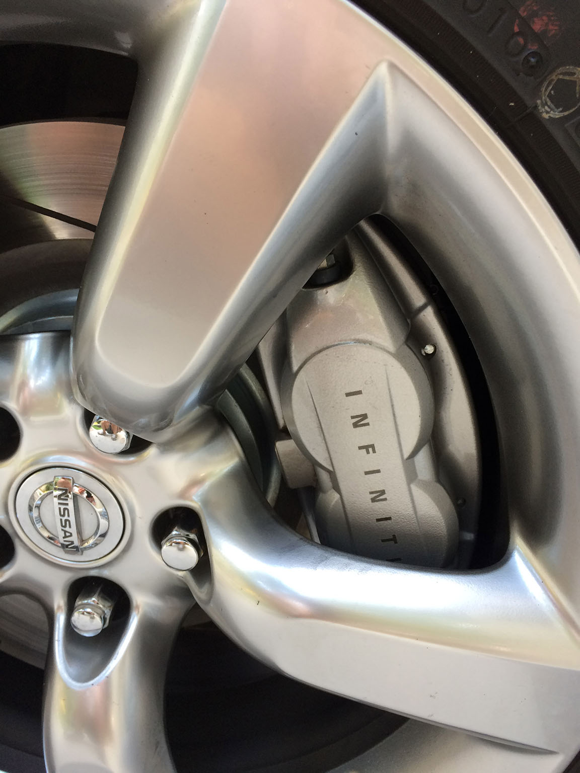

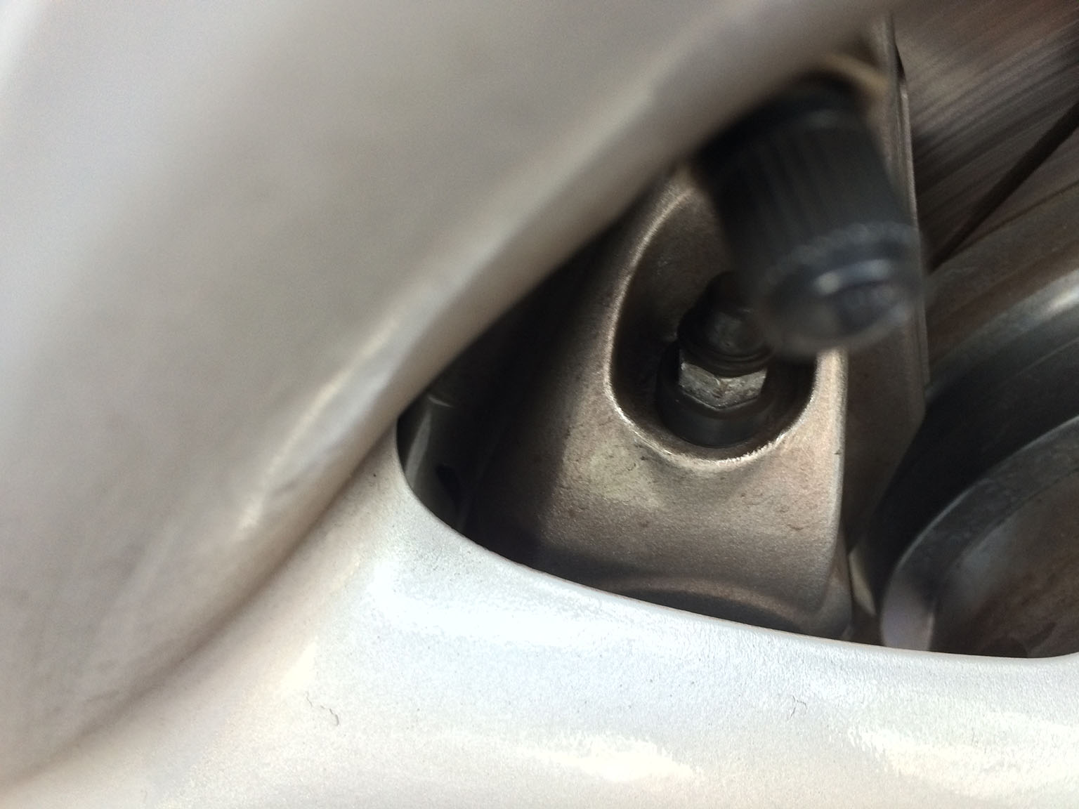

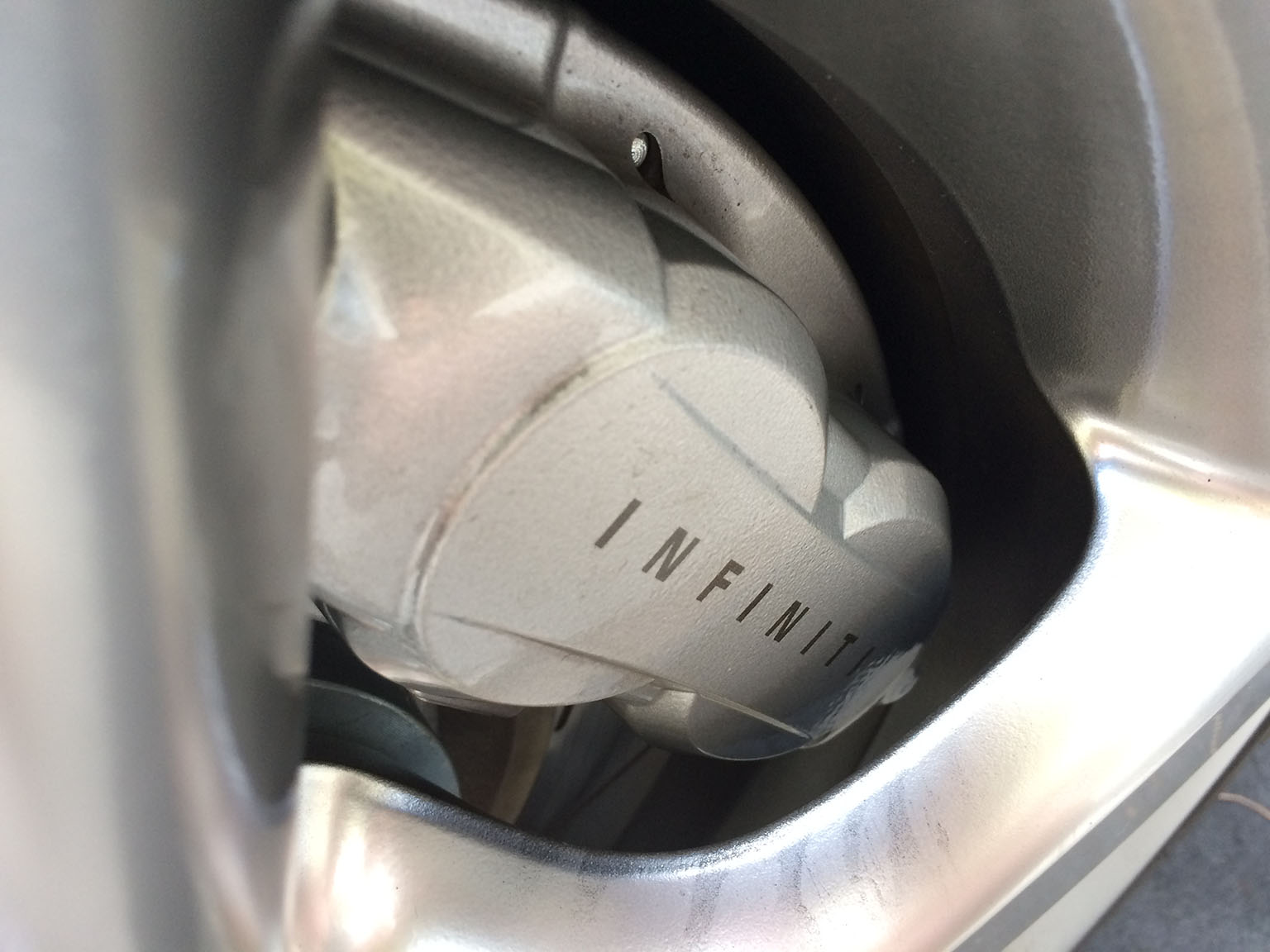

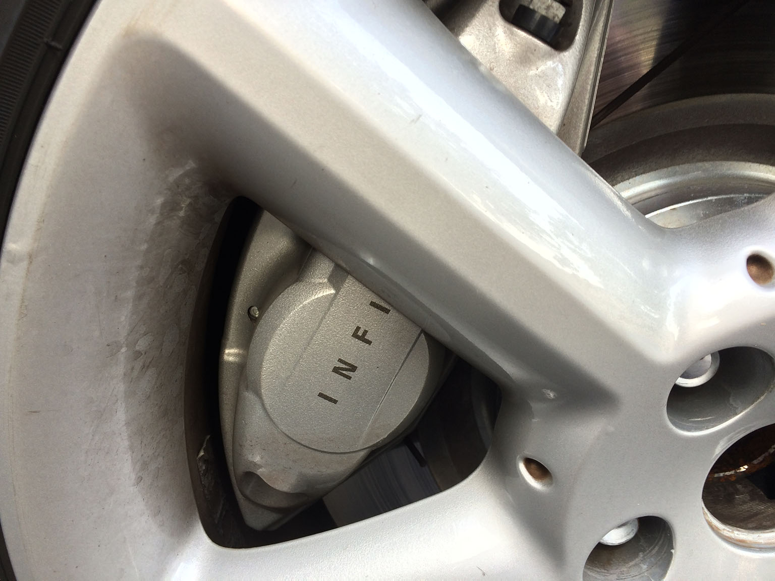

Yep the V2 Touring wheels clear the Akebonos The spokes clear with a little more room then the older V1 but the barrel of the rims are TIGHT, like no room for wheel weight tight
Attached are some picts of the Akebonos under the V1 and V2 Touring wheels for comparison...

Wow! Although I am happy they will clear my V1 touring wheels (winter wheels) I can't believe how close it is!
I cannot wait to throw these on, should have been done over a month ago but I'm so busy every weekend.

That's interesting. My akebonos definitely don't fit under my stock V2 wheels. The spokes clear, but the upper part of the caliper rubs the barrel of the wheels. Are you sure you checked the entire caliper for clearance and not just the lower part shown in the picture?

It spins without touching. I had to relocate some brake weights. After that they cleared with about the thickness of a USB port. The gap is maybe 3-5 mm... very tiny.
You can only really check after you have torqued all the wheel nuts to ensure the rim is totally centered on the hub. A quick check with just the wheel on the studs isn't good enough.
Its hard to get good pictures of the fit because one end of the caliper is slightly longer then the other. So to show the full fitment you have to rotate the spoke out of the way.
I've run one HPDE track event and a weeks worth of driving to / from work (18 mile each way) without issue with the Akebono Touring V2 combo. I ran the V1 combo for several months.

That might explain it then because I didn't fully torque it down. I just lifted the wheel onto the studs, pressed it against the hub as flush as I could and noticed it looked like there was no clearance between the caliper and wheel. Tried spinning it, didn't seem to be spinning freely, took the wheel off and saw that some dust on the barrel was rubbed away so I didn't even try putting them on after that.
Originally Posted by SQuaLZ
That is so weird. I have seen many people running the V2 with no clearance issues. That is why I ordered them not worrying about it fitting. Now you are starting to make me nervous.
Based on the above explaination looks like you'll be fine. My mistake.
