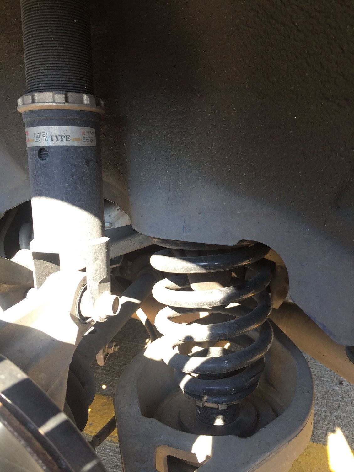

So I just recently picked up a z and realized the car has excessive body roll and handles terrible. My wife's suv has less body roll I think. So I decided to maybe raise the car up a little although it's not slam I wanted to see would it get better.
I immediately noticed it's a tight fit to get the wrenches in there so I'm wondering did the previous owner installed the springs the wrong way?? From the looks of the pictures I found online it looks like it's the other way around. Sorry for the noob question.

Shouldn't affect the ride if they are upside down or not though. It does seem counter-intuitive to have them installed in such a way that the adjusters are not reachable.

Pretty sure its upside-down and pretty sure its the source of the problems with your hanling. Its design to work properly the other way. Change asap

Yep, it's upside down.

Upside down and the BCs do not retain the OEM upper spring mount.

There is no strut.
But you'll want to support the arm, remove lower shock bolt, remove control arm bolt from hub, lower the control arm slowly, then you should be able to slip the spring out, remove the upper cone, flip the spring and slip it back in/reassemble.

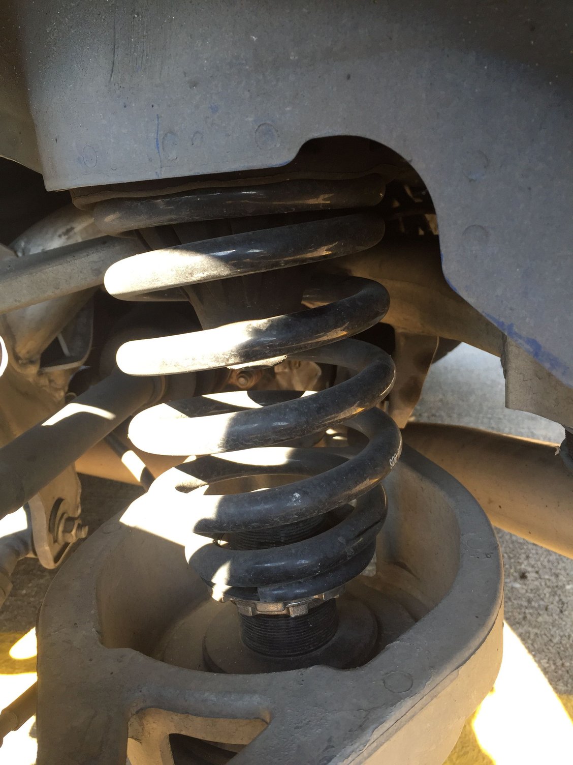

Only issue is I removed the rubber oem mount the previous owner used to install and now the rear sits lower. It's tuck and doesn't look right. I tried raising it by adjusting the spring perches but the height remains the same. I'm still a noob so I need to ask how do I adjust the rear to raise it?

Use the threaded spring perch, you will probably need move the collars 3/4 of an inch

I'm just stating a fact that lowering a car will actually cause more body roll.
Lower CG does not always mean less body roll.
It looks like OP is missing some parts. Looks like he has the black plate but not the silver plate which would cause extra sag.

The op has the tapered spring version, and doesn't need the other part.
