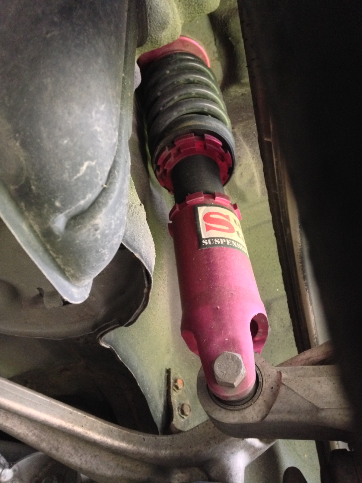

Hey guys, as you can see, I am looking to put the stock suspension back onto my 05' Z. I purchased the car a couple years ago and the previous owner had put some cheap coilovers on it. I got a great deal on it and it drove okay so I looked past it initially, but now there is rattling coming from two of the wheel wells after every imperfection in the road that I pass over. As a college student, I'm looking for a cost efficient way to replace the coilovers, which I'm assuming the best way is to simply return it to stock (If there is a better option that is also cost efficient, let me know!).
I'm wondering what all I will need to return my Z back to the OEM suspension. Based on a somewhat similar post I found, I'm guessing that I will need strut/spring in the front and then shock/independent spring in the rear? Is this the case, and is there anything else that I will need?
Here are a couple pictures, one from the bottom of the coilover and one of the top. I was also able to find a listing on Ebay of what looks to be the same coilover based on the color/sticker that's on it.
http://www.ebay.com/itm/EMUSA-RED-NON-DAMPENING-HEIGHT-ADJUSTABLE-LOWERING-COILOVERS-350Z-03-08-Z33-/191569710760?fits=Model%3A350Z&hash=item2c9a71cea8&vxp=mtr
Thanks for any help!

One month warranty - those look great.
Seriously, don't buy sh!tty Chinese coil-overs. If you can wait a few weeks, I can get you my set of OEM parts from my '08. 30k miles on them, and I'll accept a reasonable offer.

You're gonna need springs and shocks. Your most cost effective option? Buying an oem setup from someone here on the forums, there should be plenty of them. I myself have a set of 07 stock springs I will let u have for a donation of your choice, but I don't have the shocks to go with them. The cheapest aftermarket shocks are kyb and tokico hp's.
My advice, if u think theres even a slight possibility that u will get the "mod" bug in the future (going back to stock height from a lowered stance can be rough), I wouldn't spend money on oem equipment, save up around $600 and get yourself some mild lowering springs and aftermarket shocks, which will be a far better setup than cheap coilers.
