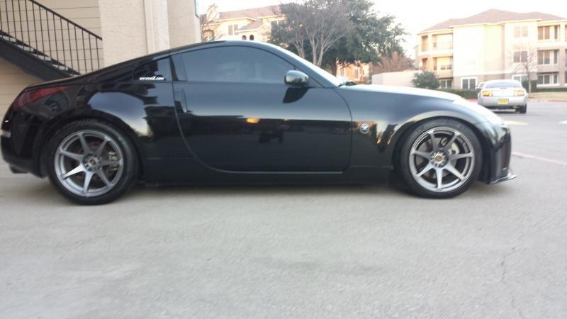

eibach pro kit with tokico d-spec shocks

travlee, did you need to adjust your camber afterwards? Looks good for a basic drop. I'm wondering if a basic alignment that corrects the toe will be enough to avoid going thru tires for a small drop like this.

yes, but i also swapped everything out... fuca, rear camber arms, toe bolts etc

Travlee's Z is almost identical height to mine. Not dramatically low at all. Just enough to make the suspension "right" for comfort and performance, IMO.
