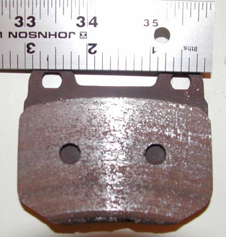

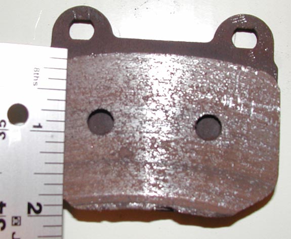

How big is the rear track edition pad? I haven't seen it - can someone give me a reference compared to either the stock rear pad or the regular caliper StopTech pad?

larger than the non-Brembo rear pad (I've never seen one, so I can't be more specific)
about 2/3rds the size of the front pad in a Stoptech ST40 caliper... going from memory, about 9cm or 10cm wide and 5cm or 6cm tall
Jason
Here's a rear Brembo brake pad... width:
Attached Thumbnails Exciting news about the StopTech rear 13" brake kit.-width.jpg
Jason
same... measuring height:
Attached Thumbnails Exciting news about the StopTech rear 13" brake kit.-height.jpg

Wow, thanks guys - couldn't wish for better info about the pads!
