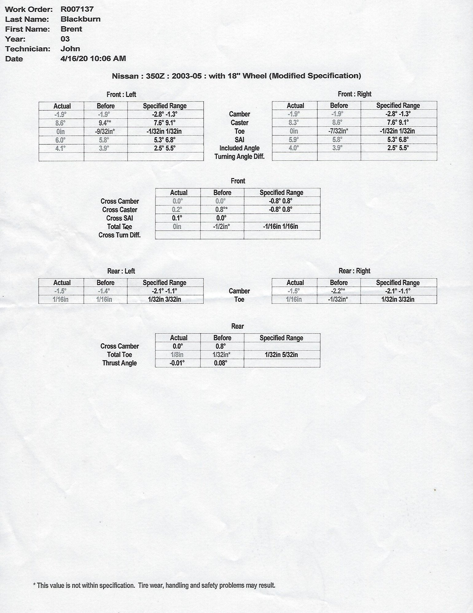

Old May 8, 2020 | 10:18 AM
rustyschopshop's Avatar
rustyschopshop
Joined: Mar 2014
Posts: 1,405
Likes: 374
From: Watauga, Texas
Just had my alignment done at texas track works. Very knowledgable staff. Had my car as well set up for more of an aggressive street setup for tire wear conservation with the grip for light weekend track duty.
