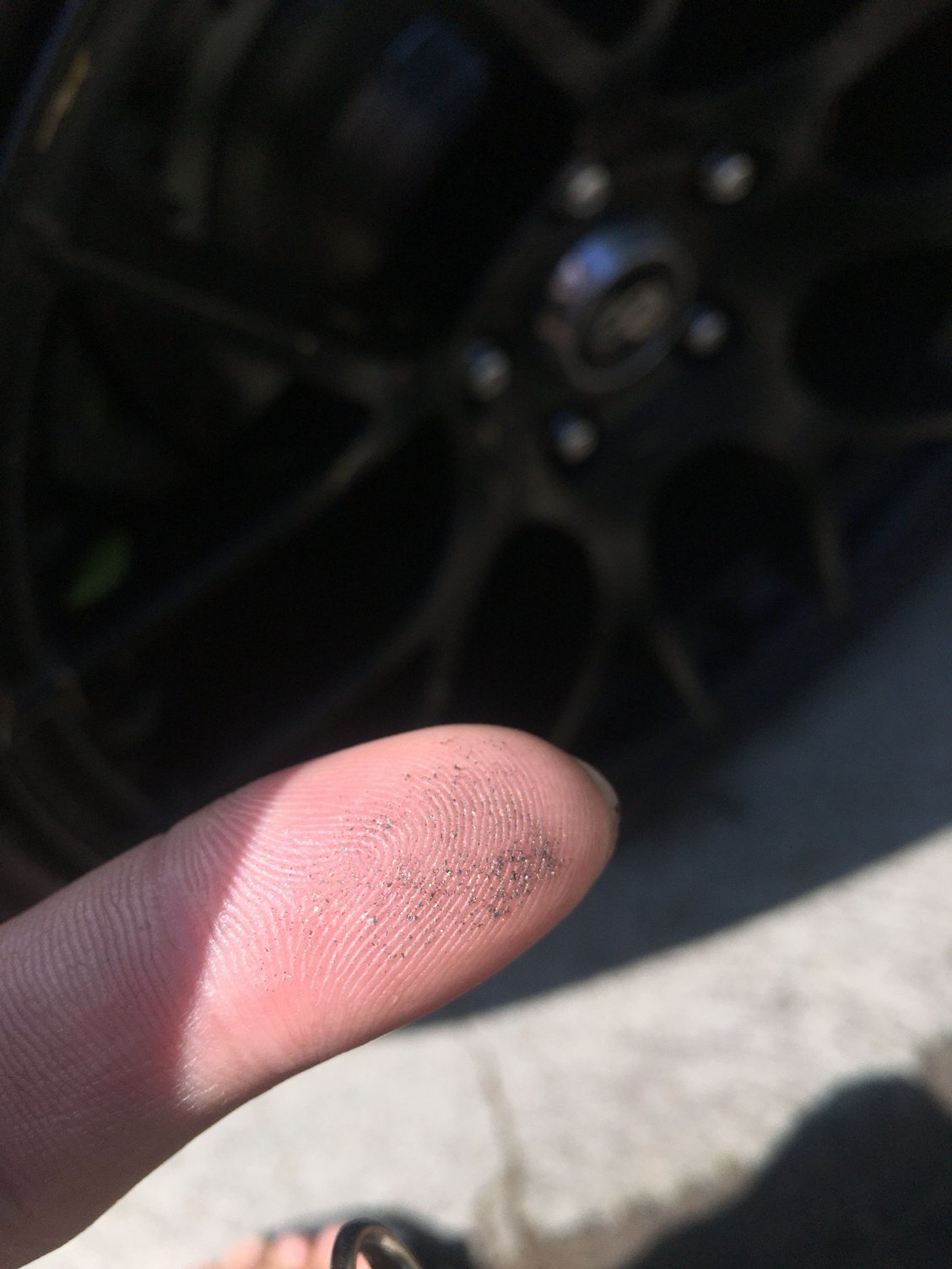

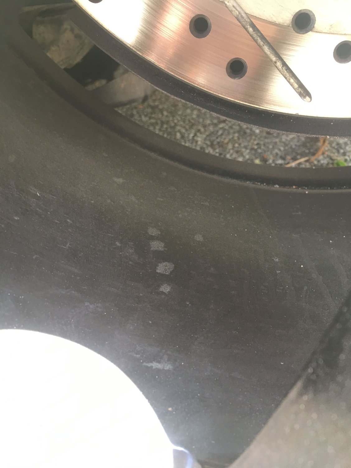

The rotor and brake pads are new (non Brembo) with stainless steel lines. (Already drove to work a couple months before with the new pads/rotors everything was fine). I inspected the wheel well and I noticed small piles of dark gray dust combine with shiny metal particles almost like the brake pads color. The passenger side also showed these symptoms but there wasn’t any noise grinding/popping noise coming from the passengers side.

Here is the gray dust piles I spotted in the wheel well.
If you look close you can see shiny particles in them as well. Not sure if it’s metal or the hawk hps pad material.

Edit: Problem solved! Apparently I missed re-installIng one of the washers that went with the 2 caliper bolts and it cause the rotor to make contact with the dust shield. The noise would go away when I brake because it would hold the rotor in place!
