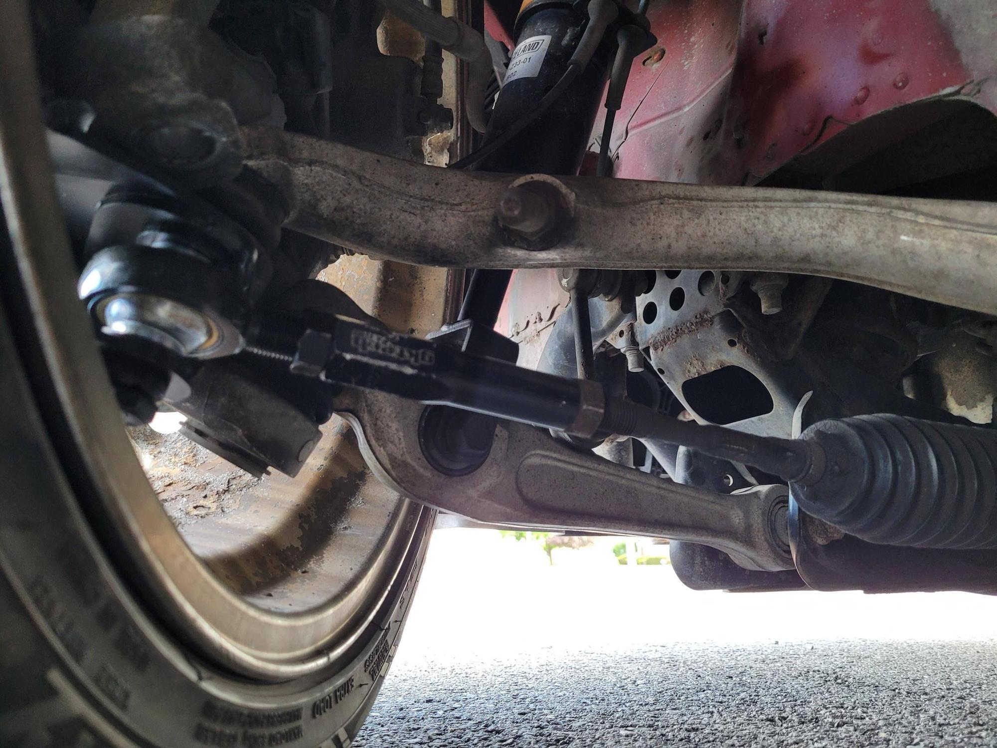

I purchased the GKTech steering angle kit, (tie rod extensions), and steering rack spacers.
Spoiler
The angle kit
INSTALL
I started with the driver side. steering stop bolts, tie rod bolt, and compression rod bolt. Slapped the angle kit on, tightened it down evenly, and began threading the tie rod extensions into the new outer tie rod and steering rack.
As I was doing this, I unknowingly rotated the part of the steering rack that threads into the outer tie rod. I'm unsure if this matters, like if there's some kind of adjustment that was accidentally made INSIDE the steering rack, or if this is just designed to spin freely to adjust toe. I'm unsure.
Anyways, I began on the passenger side. Same thing, except this time I got hung up on the compression arm bolt. I had to cut it off, damaging the threads in the process, and had to change the passenger compression arm. Finally after replacing, I was able to slap the passenger steering kit on. (This time, careful not to accidentally rotate the steering rack, again, don't know if this actually does anything or not.)

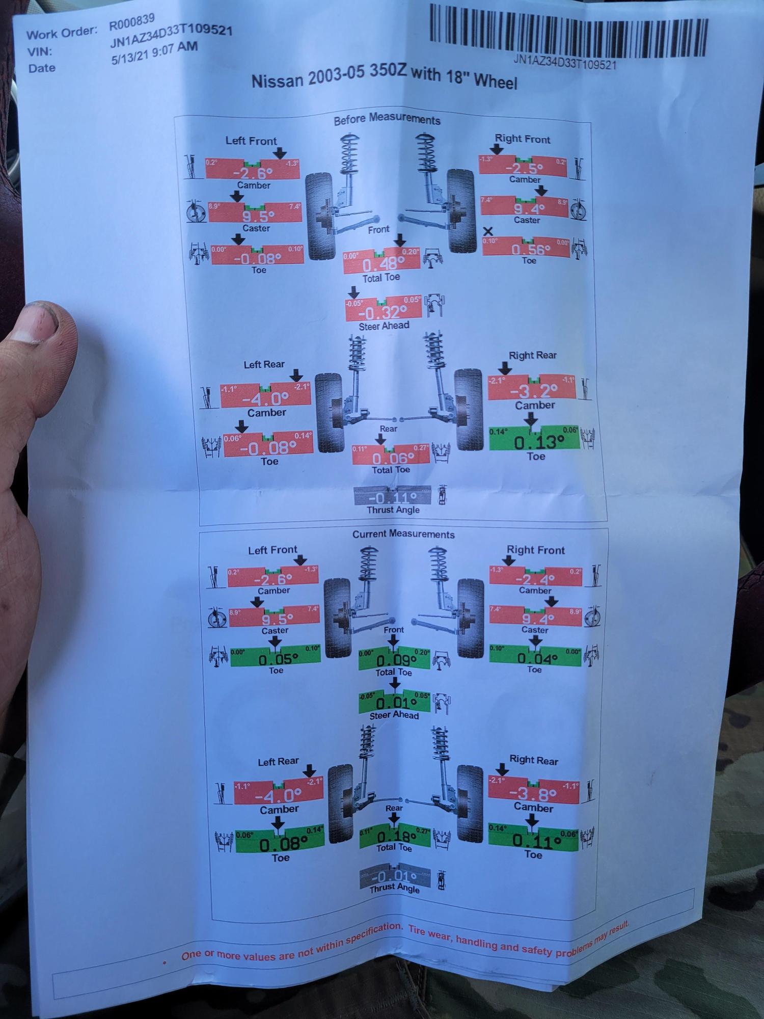

The alignment:

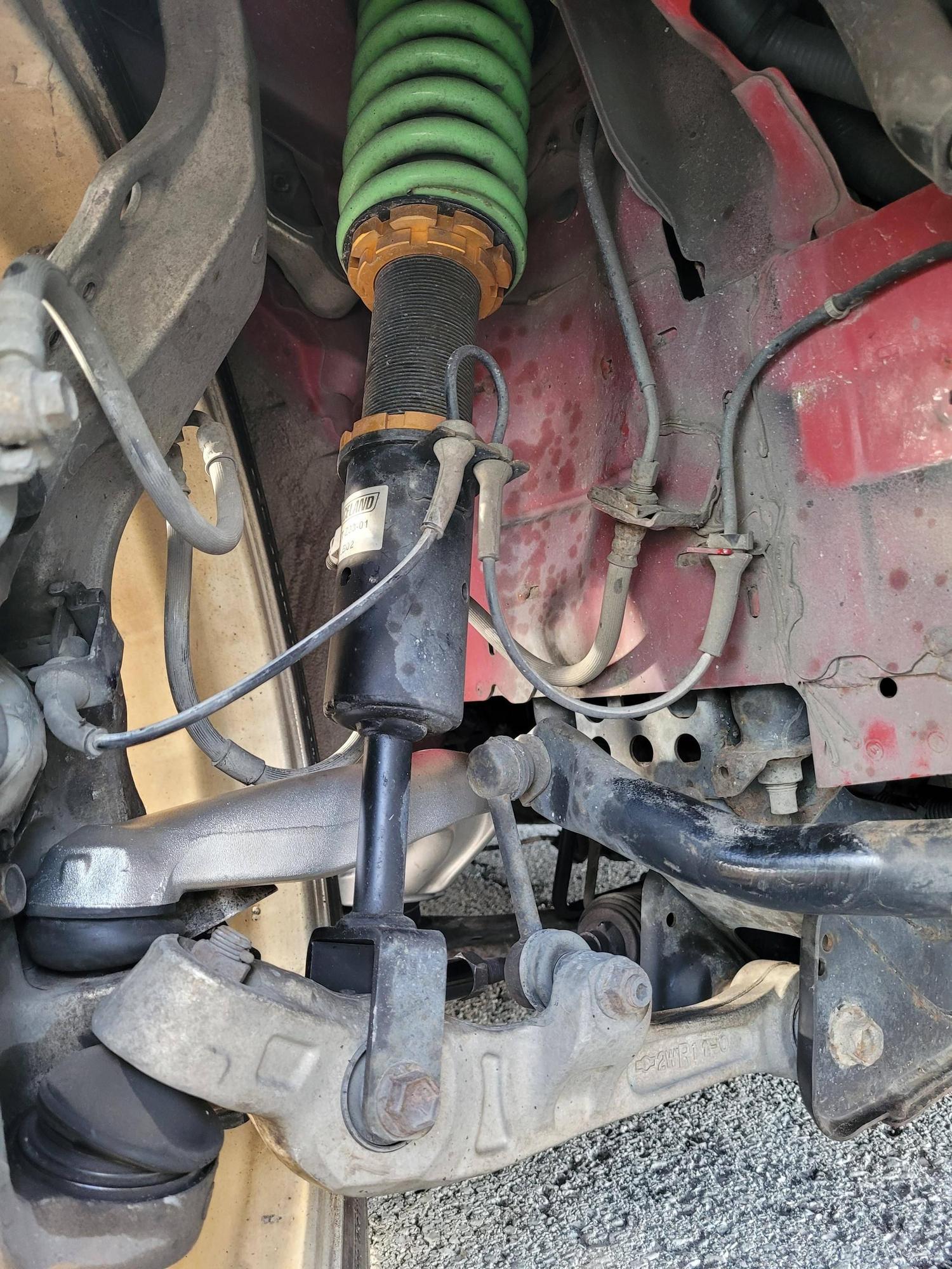

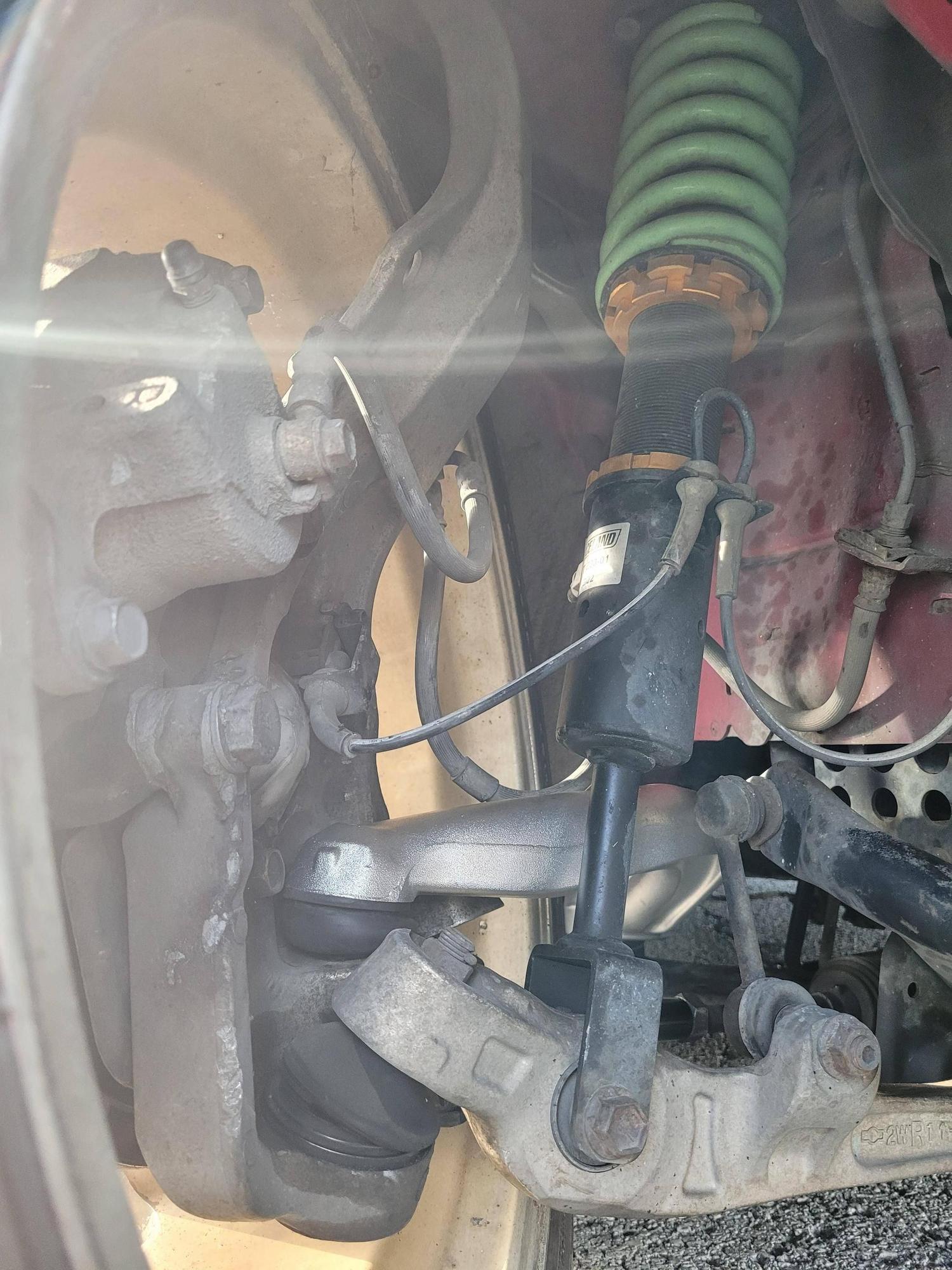

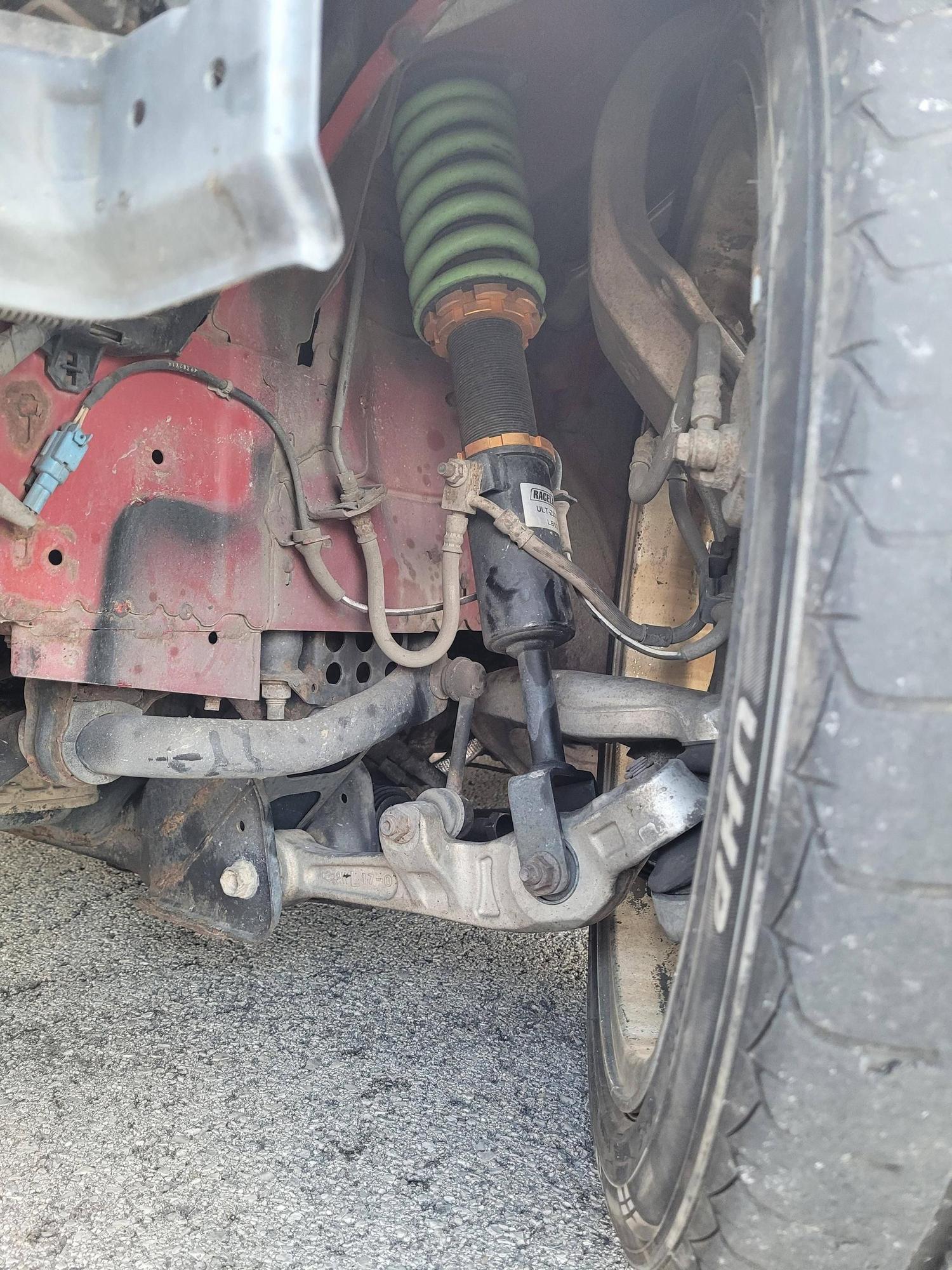

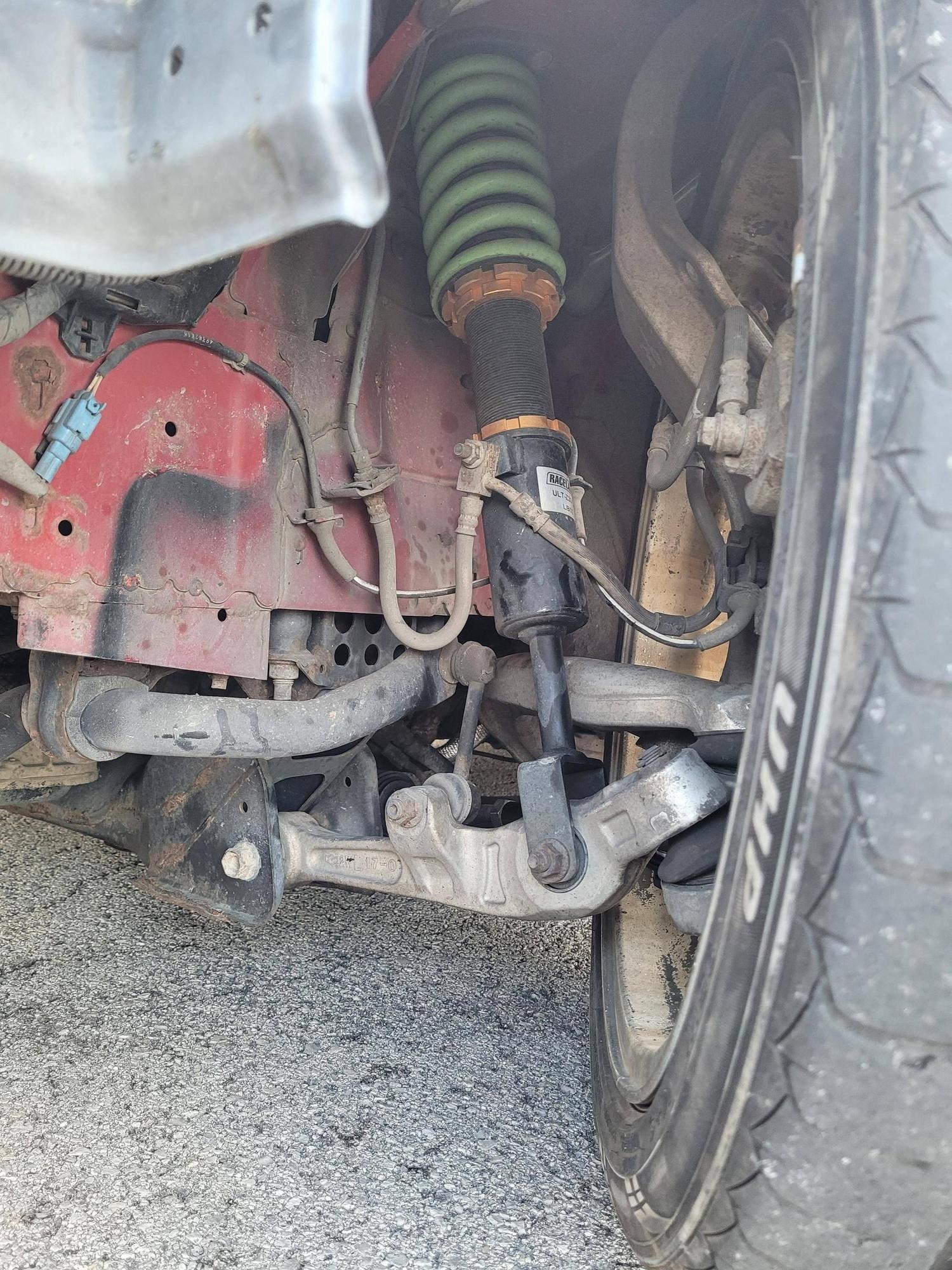

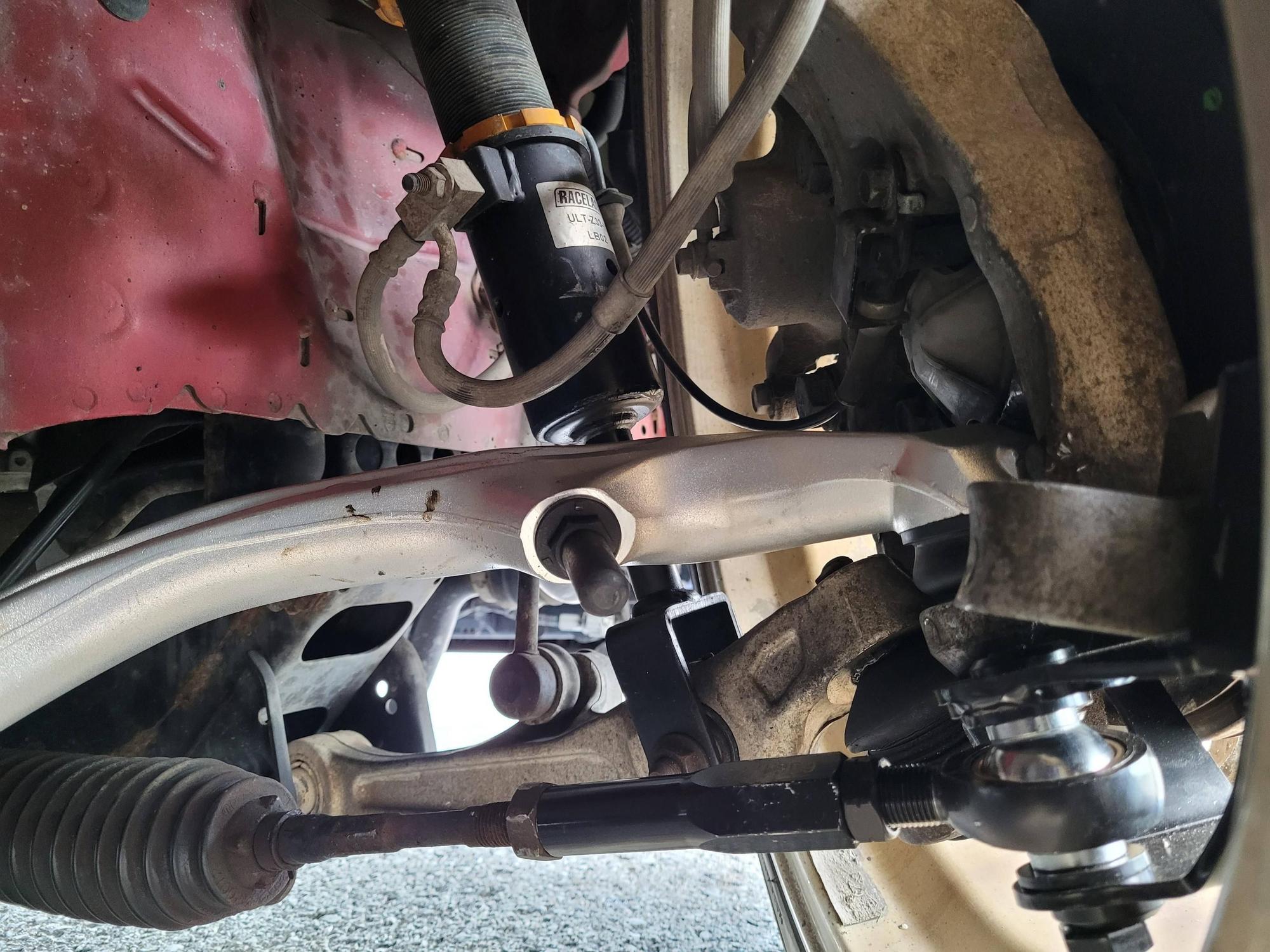

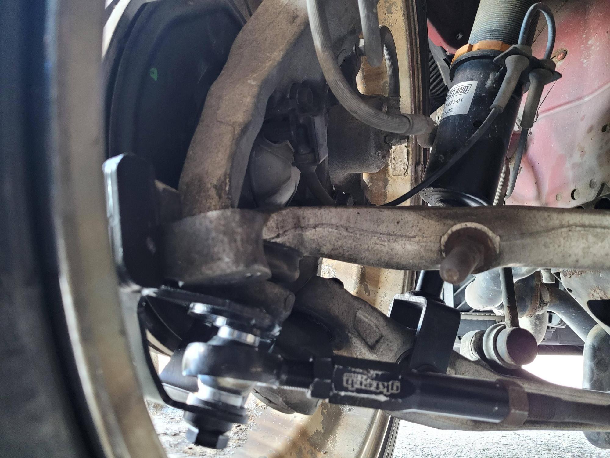

Some photos of my suspension at full lock. Notice the new compression arm to differentiate passenger side from driver:
Spoiler

Why is the brake line in front on one side and in the back on the other?

Oof. GKTech. They are some guys that have some pretty good ideas and then drop the ball on support and quality. The squealing is most likely your dust shield got pushed into the rotor during install. Just bend it back or trim it.
These are the adjustable ackerman adapters. I would be willing to bet that your currently on the parallel steer option with the rod ent point in the outboard position. You need to change it to the inner position for street driving. For actual drifting you will want it in the outer position. Get you a set of toe plates and get used to adjusting your front toe yourself.
Dont worry about spinning the inner tie rod. There is a ball spherical that allows it to spin without damaging the rack at all.
