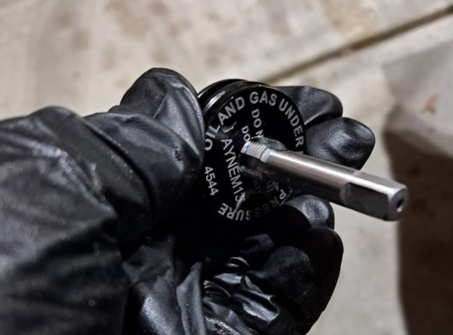

I had expected the REV9 coilovers to have a method of external nitrogen release, but there wasn't, so I had to drill into the sealing piston (see previous picture). I've rebuilt BC Racing shocks in the past, and those have a septum style seal. It's just a self sealing silicone plug that can be pierced with a needle.
Since the REV9's don't have this, the best method is to drill through, tap, and screw in a schrader valve. I bought some cheap schraders off of Amazon that had a pipe thread end. I tapped it by hand, which isn't the best or easiest thing to do in the world, but it works. I used some liquid pipe thread sealant to make sure the nitrogen stays where it belongs. Here are some pictures:
Tapping the outer cap:
Screwing in the Schrader valve:
