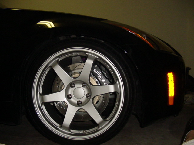

Bat, how come you didn't consider our Wilwood kit. I would of hooked you up with a great deal. Our GB kit is currently going for $3500 and this also include 6 pistons front 14" rotors and 4 pistons back 14" rotors. Using Wilwoods 2 piece rotors. Your choice of cross drilled + slotted, cross drilled or just slotted.
Come in the standard black color. But also available in red or blue. Below is a few pix and few threads for anyone that want to read up on it.
My opinion it will def. give any kits on the market a run for their money.
